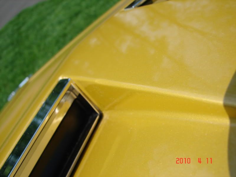

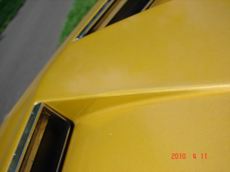

                    On the subject of BB hoods, take notice of the edge running front to back on the bulge and the grind/sanding/mold(???) mark? It's on both of my cars, the LT1 and the LS5, only on the left edge in the bulge. Is this from the mold or something else? Anyone else have these marks?
