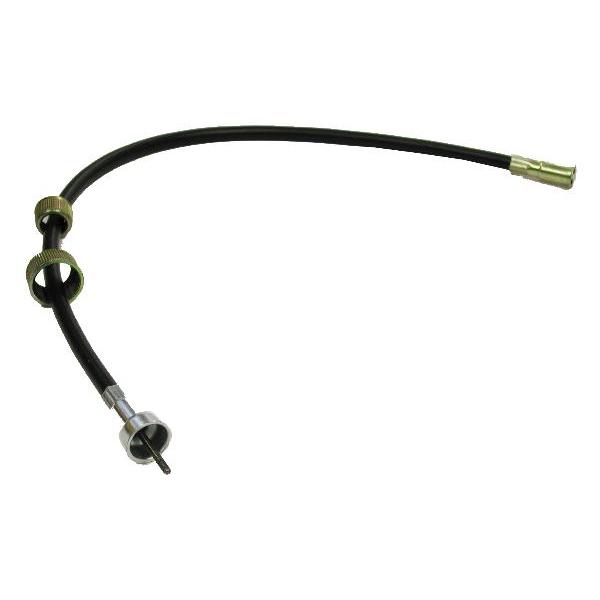

    I ordered a repop from Paragon that has been on the car for judging. It has been dinged one point because of a non-typical factory style crimp on the end.
    Thoughts on this one?

    Chris, I am not a tach cable expert, but there is one on eBay, bidding for which expires at 5 PM PDT on Aug 9. It has the 6-sided crimp on both ends and looks a lot like my original 67 cable. http://cgi.ebay.com/ebaymotors/ws/eB...tchlink:top:en

        Chris -- here's the distr. end of an original cable I have -- forgot where it came from. Note the TELEFLEX marking. This is a 6-sided crimp. Can't recall what the cluster end looks like, but I could dig it out and photograph, if needed.

          The distributor end of the cable has "TELEFLEX" and "3", with a six-sided crimp. The smaller (instrument cluster) end has "TELEFLEX" and "4", also with a six-sided crimp (pictures next post). I'm sure there's a name for the screw-on cable end-caps, but I don't know what the correct term is. The overall length from 'far end of end-cap' to 'far-end of end-cap' is about 23 3/4 inches when I stretch the cable out straight or follow the curves of the cable with the tape measure, but I couldn't do that and take a picture at the same
          Pictures of the distributor connection end of the cable:

              That is the genuine item.
