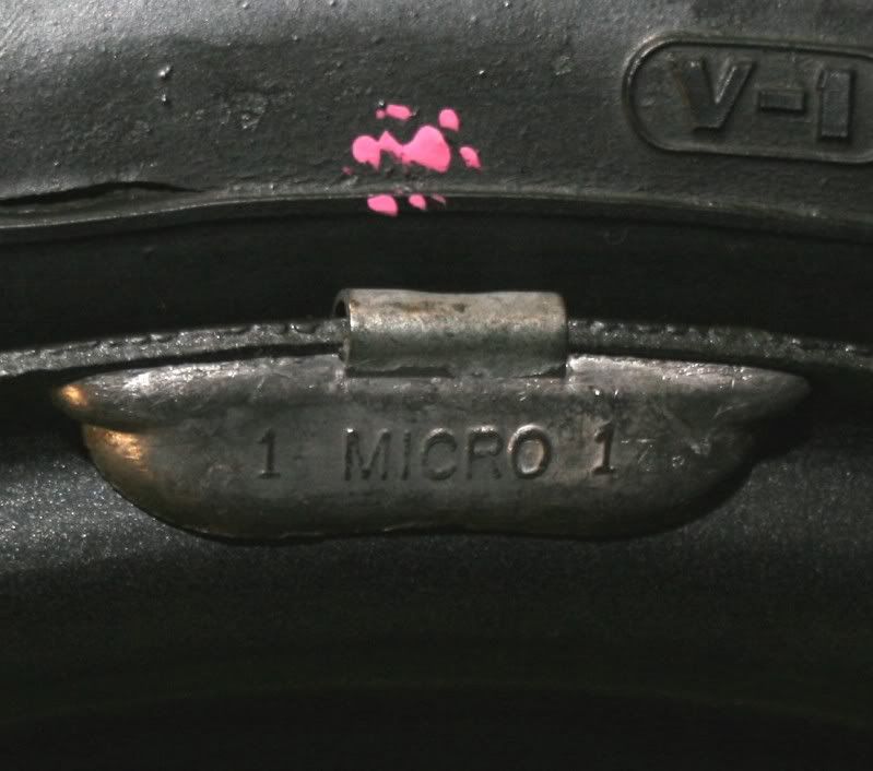

                Attached is a picture of the wheel weights from my 68 original spare tire. It has the weights of two different manufacturers side by side.
                John

                    Thank you all for the pics and great info. Jeff
