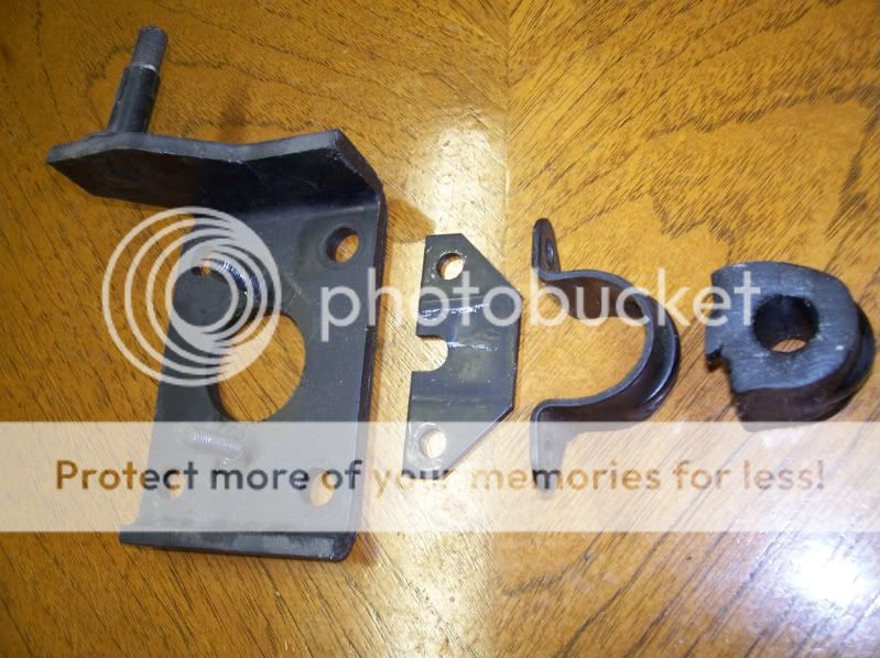

            [quote=Tom Parsons (3491);499171]The parts that are missing on your car (4 for each side) are the 60-62 style anchor plate for the leaf springs, a flat piece of metal that is kind of irregular shaped with 2 holes, a U-shaped bracket with 2 holes and a rubber bushing for the end of the sway bar. This rubber bushing fits into the U-shaped bracket. /quote]
            Here's the parts:
            (I never did get around to installing the rear bar on my '59!)
