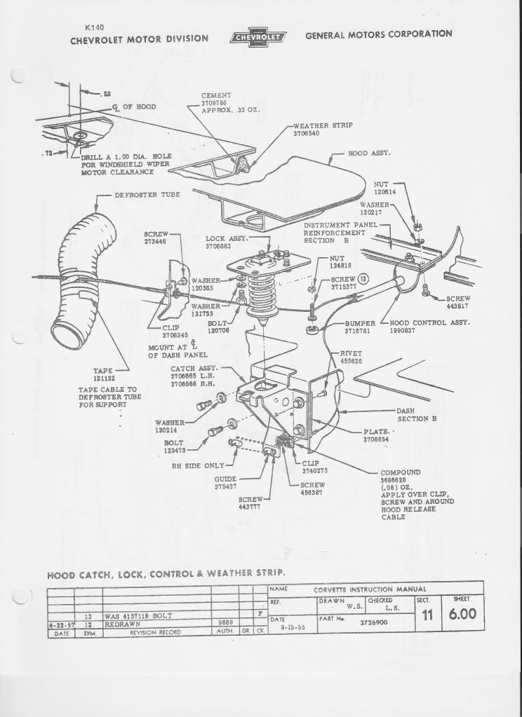

    Does anyone have a picture of the correct location and position of a rear hood weatherstrip on a "57"? Thanks.

      Ed - AIM page K140 Sect.11 Sheet 6 below shows an illustration.

        Ed, hood weatherstrip photo is in 5th edition Judging Manual. Gary....
