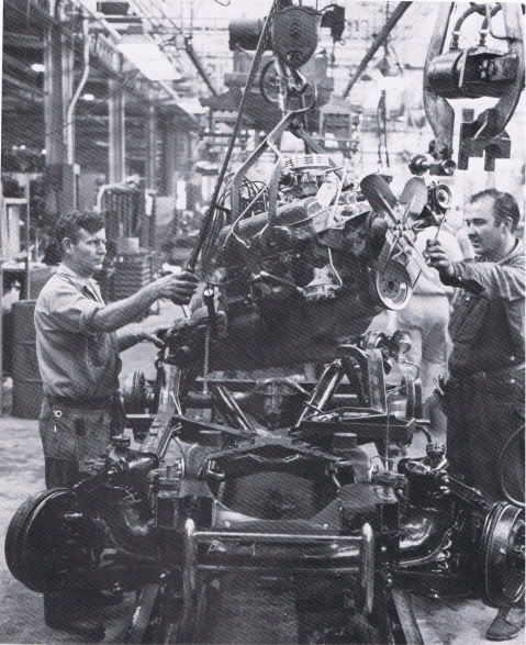

    • Wayne W.
      • April 30, 1982
      • 3605
      Re: Engine removal by exhaust manifolds
      Whats the old saying? Whats good for the goose...
      • John D.
        • June 30, 1991
        • 874
        wayne,
        I'm not sure what's scarier, the engine hook or that spring compression fixture hanging over that guys head.

                        • November 30, 1997
                        The engine dress line hooks carried them that way for almost 20 years (photo below is 1959).
