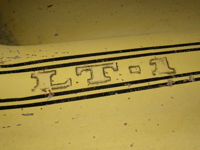

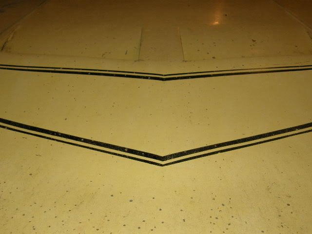

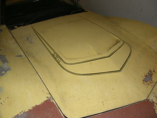

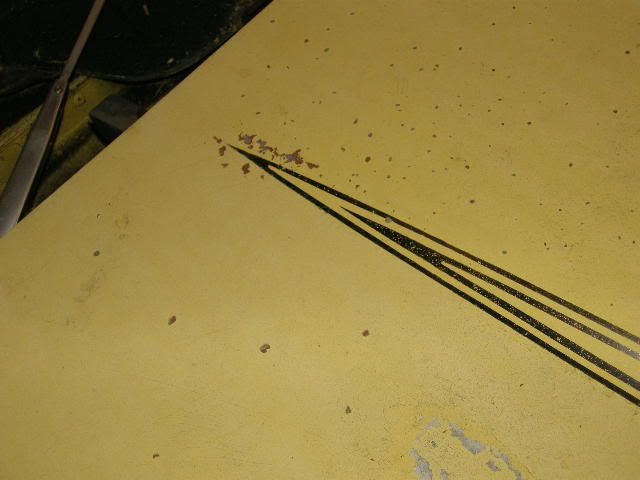

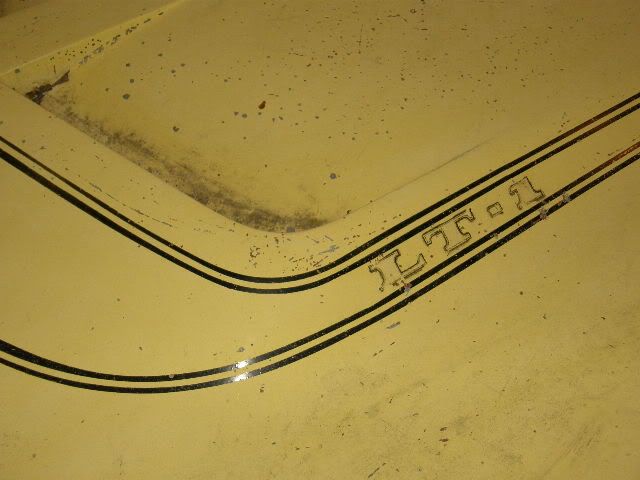

                          Here are some actual pictures of the car John is refering to. The paint job and hood stripes are original.
                          Reading in the "1970 - 1972 Corvette Technical Information Manual & Judging Guide" I found the following:
                          "The last un-equal hood stripe now known is on 1970 s/n 15889..." and "The first equal-width hood stripe now known is on 1970 s/n 16448..." This car being 16148 falls right between those s/n's. Everything else in the guide also indicate the stripes are correct such as the stripes coming to a point in the front, the white outlined "LT-1" and the mask marks which are all visible in the photos.
                          This car is very original so is it possible that it could now be the "new" last know un-equal hood stripe 1970 LT-1?
                          I would be interested in any further comments about this.

                            There must be something wrong between your photos and my monitor. Those LT-1 decals look silver on my monitor. I suspect we have reached the limits of the Internet to support our fixation.
                            I have heard from someone with a higher number than 16448 who has unequal width stripes, and claims them as original. I have seen no photos, nor have I seen the car. It is possible that for some time they used both style masks simultaneously.
                            I hope the rest of the car is as nice as the hood.
