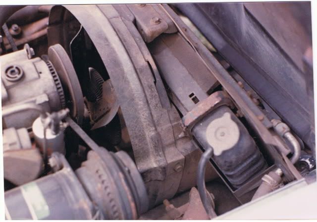

            In the mean time here it is on a 68. Note the angle cut and no hole on the left. Small Block with AC BTW.

                I don't have my 67 AIM here, but, I can tell you that if there was a change to the angled RH side, it wasn't in 66.
