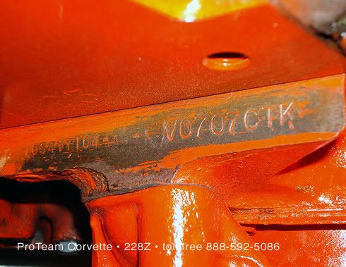

    This looks typical for a few LT1's I've see - as far as having the suffix appear to be stamped separately/deeper in the pad. Here's a reference pic I borrowed from the ProTeam site a while back of another LT1 stamped the same day as the pad in your pic, although the suffix isn't as deep. The stamp placement is almost identical, although the "0"'s are a bit different.
    If the factory broach marks are present on the pad, I'd be leaning toward saying the pad in your pic is original, but... let's have the "experts" can weigh-in here...

      Given the "Patina of age" matching the surrounding area, there is a high probability it is good.
      Bill Clupper #618

        John here are 2 photos of a 70 LT-1 we judged and accepted as a factory grind out. Its has many features as your photo has. Plus the build is very close to the car your looking at. Paul 18046

                  For those of you who may be interested, I went and looked at this car and can offer the following.
                  The engine pad does have broach marks, dim but there. What's really interesting is that the engine code and date stamp are nearly identical to the one posted by Paul Olansky which was made ON THE SAME DAY and had both an O and a 0 in the same positions. What are the chances of that being faked?

                    John after looking at the stamp pads next to each other. The same holder and stamps were use on both engines. Each photo was taken at a slightly different angle causing a small deviation but the change from number to letters is almost exact. I would say the pad is good. Just my opinion others may see it differently.
                    Paul 18046
