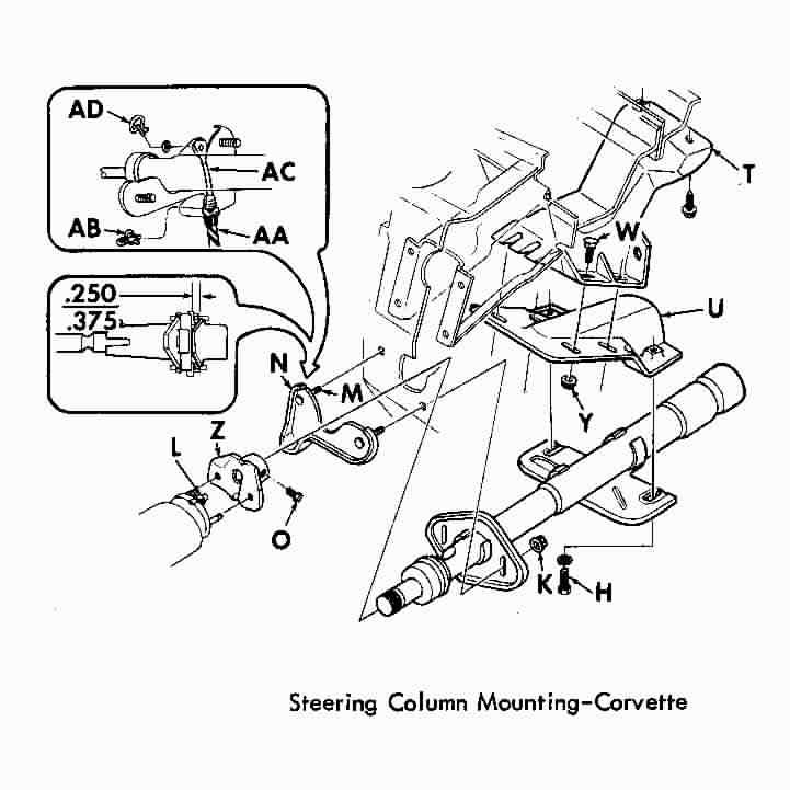

    No, you don't have to remove the instrument cluster in order to remove the steering column. You should disconnect the battery and then remove the steering wheel. Here are the rest of the procedures:
    1). The turn signal switch "harmonica" connector can easily be reached and disconnected from the vehicle wiring harness after you remove the plastic panel, the metal bracket, and the air distribution hose crossing under the steering column.
    2). You will have to remove the two nuts K from inside the car and release the lower end of the column on the floor pan. Remove the fastener AD and washer that attach the interlock cable AC to the pin on the lever on the lower end of the column. You can now remove the plate N on the dash in the engine compartment.
    3). Remove the two vertical screws and washers H that hold the column up into the dash.
    4). Now you can reach and remove the two electrical connectors on the vehicle harness that attach to the ignition switch.
    5). Remove the two nuts and lock washers that connect the flexible coupling to the steering column flange.
    6). Place the interlock lever on the lower end of the steering column in the full UP position. (There is a cutout in the dash panel that allows the lever to pass through when it is full UP.) You can now pull the steering column back into the driver compartment.
    Jim
