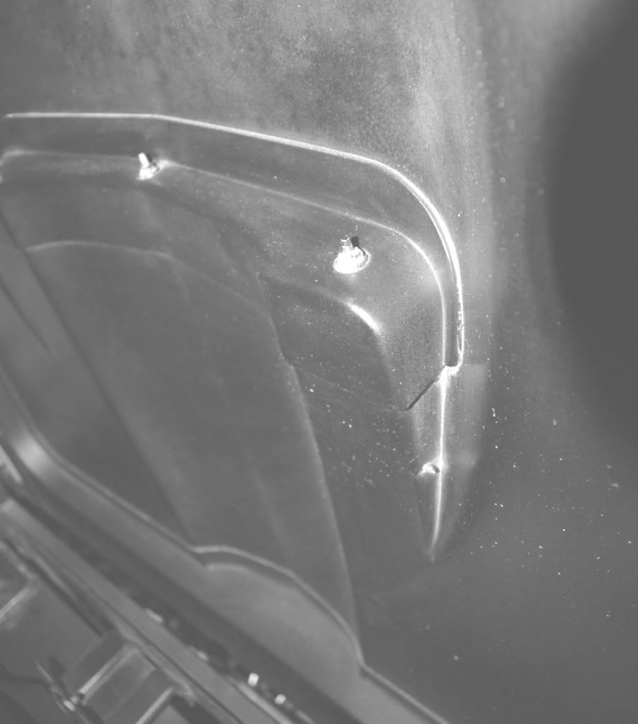

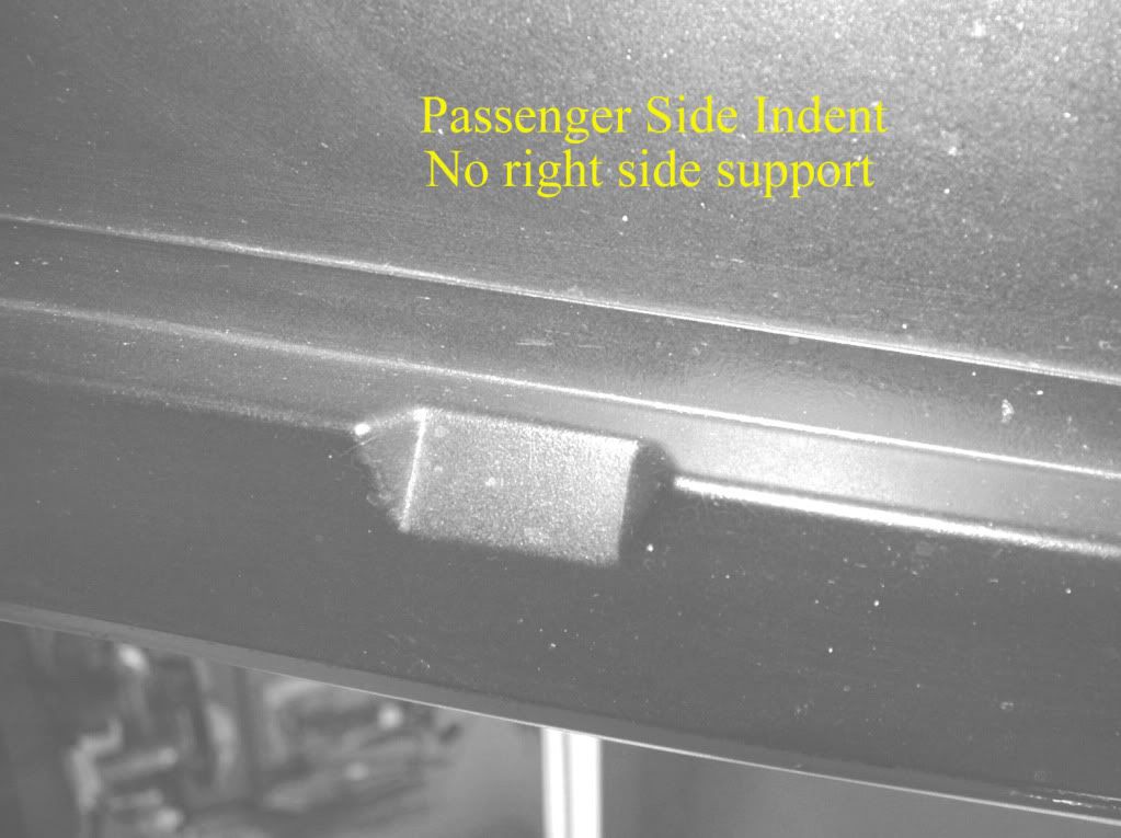

    Interested in your opinions on this manufacturer of this 67 big block hood....

    Its very hard to tell from those pictures.The only thing that jumps out for me is the bonding of the skin under the ledge. On originals the skin makes the outside shape and is usually visible where it is bonded. That bond does not look right, but there is so much paint it is hard to tell.

      Jim, I know I don't have a big block, but the three rivets on my hood are not perfectly centered like those are.
      Seems like in my short history of looking at parts, if a detail is TOO perfect, it is a repop.
      But please, don't take my word for it. I'm still new to this game.
