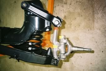

                              And now, for a few pictures of paint markings on frontend parts.
                              These are from John's 57 Airbox racer after I disassembled the frontend.
                              Here are the same parts after I cleaned them up, blasted them and returned the colors/stripes as close as I could to their original markings.
                              The book states gray stripes on the HD coils, so, here are the stripes.
