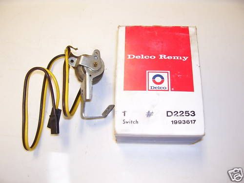

            Does anyone have a photo of this part(s) they could post? If I remember correctly I have an older nuetral safety switch from a Corvette in the archives, I will try to dig out tomorrow if I can, and would like to compare it to something to see if this is what it is. I guess I could crawl under my 63 (which has back up lights), and look at that one, but then my question would be: Do the 1993617 and 1993637 look the same with only internal differences?

              Here's a photo of an NOS 1993617 switch:

                  The 637 switch is the same except for an added purple wire for the backup lights. My 63 is too early for backups, but I have a 637 switch that I would be willing to trade (not for sale) for a 617.

                      Thanks for the photo Todd, now I will have to do some digging.
