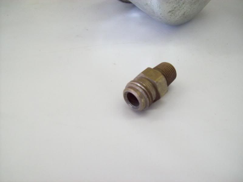

    BY ANY CHANCE would anyone know the part number (Weatherhead or Edelmann brand) for the fitting that connects the 59-61 canister type fuel filter to the fuel meter (or does it even exist anymore)? It's somewhat of an oddball fitting, probably used only in VERY few applications.

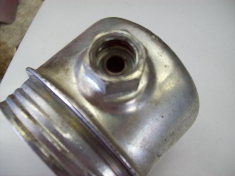

      One end of the fitting is 1/8in male PIPE thread (screws into the fuel meter cover). The other end is male thread for an inverted flare 5/16 tube. The INSIDE of the outlet side of the canister lid is like a female fitting for a 5/16 flare fitting. The center of the fitting itself has a hex for a wrench.
      When I received the FI unit for rebuilding, it had a "rigged" fitting that was sealed with some kind of epoxy sealer. I just need to put it back together with a correct fitting for the owner (restoration shop in KC).

        Anyway, I've got a solution for you. Get a Male Connector, Weatherhead 68X5. This is a 5/16" compression fitting/1/8" male pipe combination. Cut the end off a 5/16" steel tube with an inverted flare end; make the cut about 1/4" from the end. Slip this cut end with the flare into the 68X5 and screw the combination into the fuel filter.
        That's what I found when I disassembled mine and it's worked for at least 31 years without any leaks at all.

          I finally found the Weatherhead(1514) and Edelmann(261520) part numbers for the correct fitting. And, my local O'Reilly store was able to get the single fitting that was in the local warehouse!!!
          In the Edelmann catalog, the fitting is at the bottom of pg 18 and it's referred to as a Plymouth adapter!
          Fits perfect!

              I did a test fit of the fitting in the picture above. Works perfect. But there was only ONE in town. So, I'm looking forward to receiving the ones I ordered from John for inventory.
