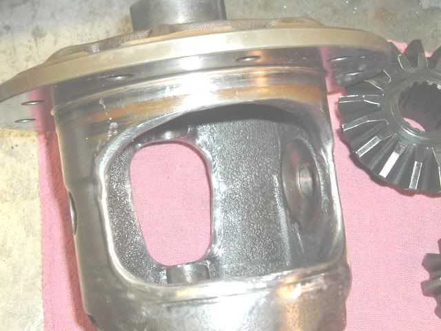

          Re: Differemtial ID
          Post a picture of it, showing the bearing caps and posi. If original it will have no cast in tabs on the caps, the posi would be the small window. A 77 would have the tabs and the tear drop window. Other then stamped numbers the 77 is a better unit.

              Re: Differemtial ID
              This is a 68. Typical of 65-68, although not all have been hit by a pinion. This was caused by a previous rebuilder. I'd say 50% of all original 65-68's I open up have cracked posi's compared to less then 10% of the 69-79's. You can see the caps as well.
              Here is a 69-79 Tear drop type
