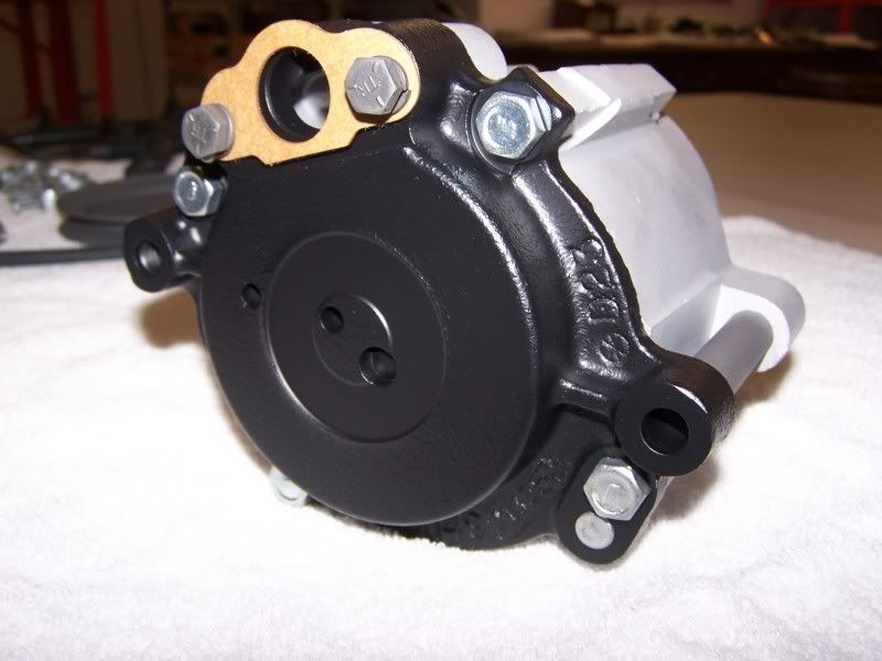

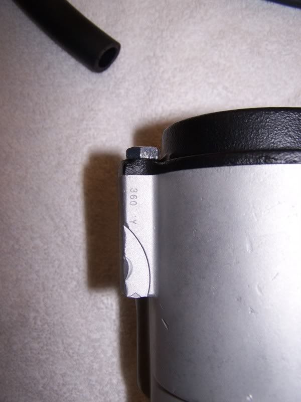

    this is a direct copy from an email I received yesterday from Bill Hodel: "You can find the date and broadcast code of the pump stamped into the aluminum housing of the pump. It can stamped into a machined area, or to the rear of the machined area. Most of the time on 68 pumps with the pressure relief valve, it is to the rear of the machined area. Pump should have 7801149 back plate and the pressure relief valve"

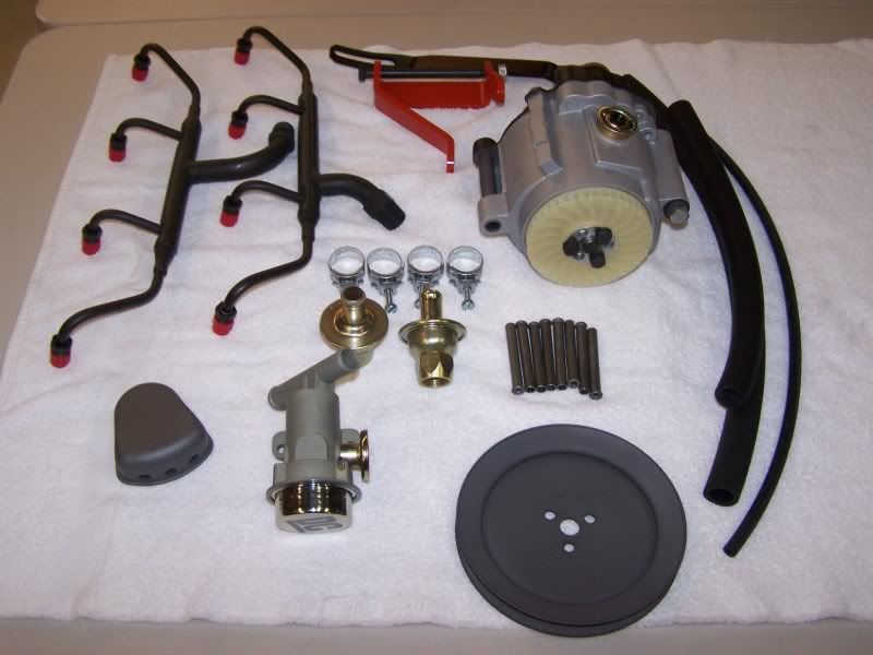

    Attached pictures from Bill as well. Seems to be julien dated.
    Again: credits to Bill Hodel!!!!
