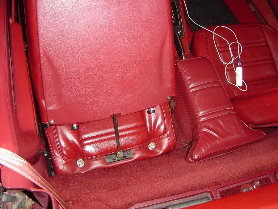

    Thank you Paul. The pics show me pretty much what I wanted to see. The seat back bumpers do not line up with the seat back stop bolt on the bottom frame on my drivers seat. Took the seat out and saw where it was bent at the back and also on one side. Short of taking out the passenger side to compare frame to frame (which I will probably do anyway), I wanted to get an idea of what it should look like.
    I see what you did with the reinforcement, but I would have to think the frame needs to get back into it's original shape before welding on a reinforcement.

      I lined things up with bolts so there would not be any mistakes with the welds. And of course removed them afterward.
