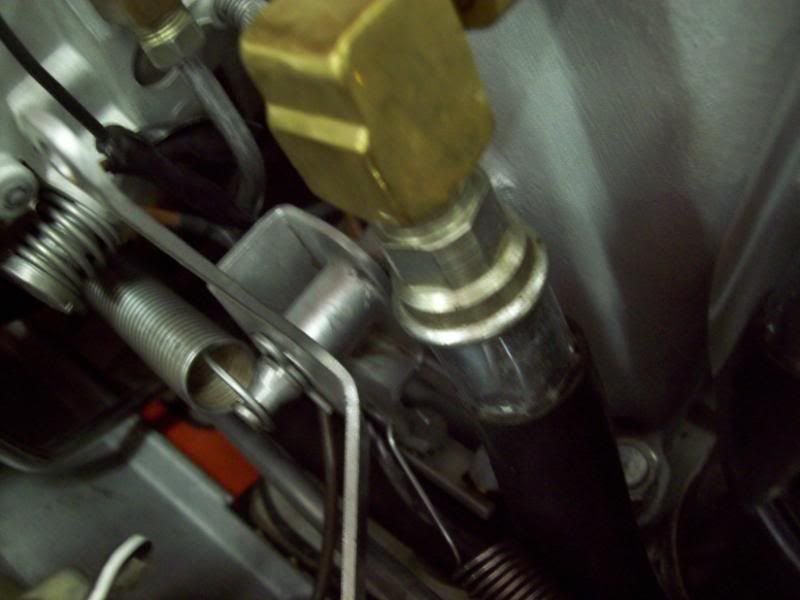

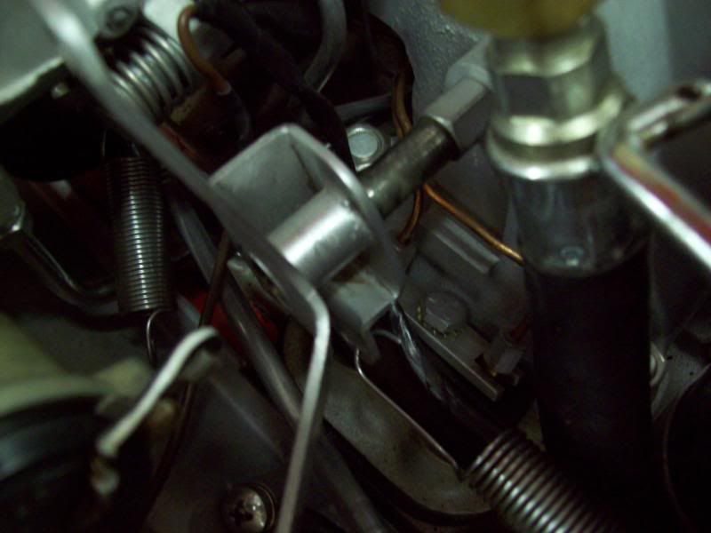

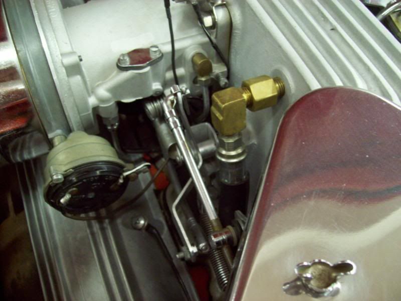

                Do you mean like this?
                It is totally, completely, 100% NON-correct for NCRS, but it sure eliminates a sloppy FI bellcrank! Of course, most everything on my 56 is incorrect!
                I did this years ago to the bell crank on the FI on my 56. I drilled out the holes in the bell crank to accept a piece of brass rod that I had lying around, then drilled a hole through the piece of brass to make a nice slip fit over a stock diameter stud and then had the piece of brass brazed to the bell crank.
                I pulled the bellcrank away from the FI plenum just slightly so that I could get a better picture.

                  Tom, yep, that's a great, permanent solution to the sloppy bellcrank problem.
                  That's a nice FI unit you have on your '56.
                  Jim

                    Tom, that's the bomb! Great solution for a car that's driven, someone should make these!
                    Dan

                              Nice fix on the bellcrank.
                              Is that a 62 air meter on you early finned plenum FI unit?
                              Bruce B
