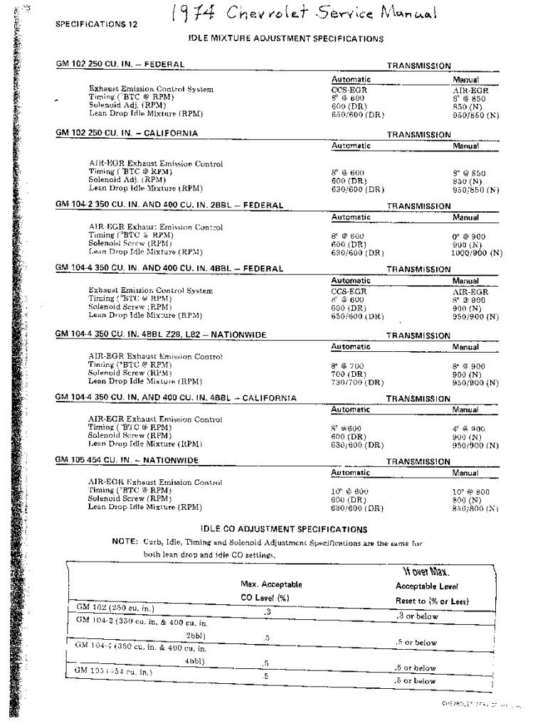

          I received the 1974 GM Service Manual from EBay. A bargain for $12.00. See 104-54; it confirms that a 1974 L-48 with TH400 did not have an AIR system. But it did have something called CCS. What is that? The PCV?

            [quote=Paul Latour (38817);483384]I received the 1974 GM Service Manual from EBay. A bargain for $12.00. See 104-54; it confirms that a 1974 L-48 with TH400 did not have an AIR system. But it did have something called CCS. What is that? The PCV?
            PAUL-
            I believe the C.C.S. stands for; "Controlled Combustion System". I'll have to do alittle research but maybe someone out there will recall right away.
              Paul-------
              "CCS" is the abbreviation for "Controlled Combustion System". This was an exhaust emissions control system that I believe was first used by Chevrolet for the 1968 model year for many applications with automatic transmissions, but not for 1968 (or 1969) Corvettes.
              It was first used on Corvettes for the 1970 model year for all engine applications except LT-1. 1971 was the same except also excluded was LS-6.
              Controlled Combustion System used a combination of carburetor and distributor "calibrations" to achieve the required level of exhaust emissions control for the particular year model. Obviously, it was a lot less expensive system than air injection reactor. The downside is that it often creates driveability and performance problems.

                PAUL-
                Maybe this will help? I've got more if ya need it.
                Marty

                  Yes, Joe. Probably ported vacuum and retarded timing to 4* BTDC with no vacuum advance at idle. I am using manifold vacuum and 12*BTDC (36* at 2500 with a B26 can) with no pinging. I'll stick with it.
