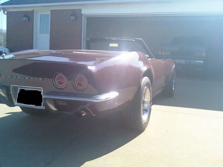

Got new tires put on today they're bfg's size 245/60/15 on the original 7" wheels incase someone wants to note how a 245 looks on a 7" wheel like I did before I put them on but couldn't ever find anyone running this size on 7" wheels.
I had them try 255's at first but in reverse and at full lock they barely barely rubbed the frame where what looks kinda like a bolt smooth top head is and rubbed a shinny spot so I backed off to 245's which is a better suited tire for a 7" wheel anyway.
