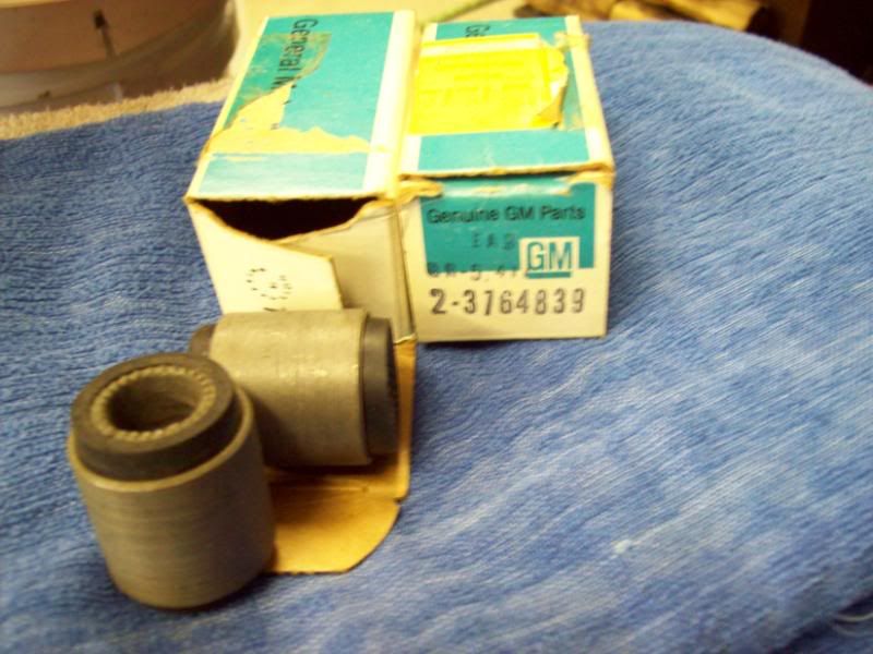

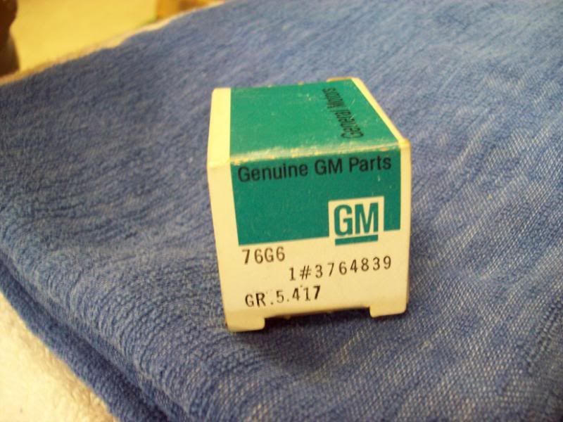

                OK, I KNEW that at one time I had bought them from Chev Parts Dept 2/box. So, I started going through my boxes of misc parts.
                BUUUUUUUUUT, as you can see, I have TWO different types of the SAME part number. One is a box of two, the other is a single in a box.

                  Tom, I see these are much better quality than what the reproduction part is. I'd be curious to know what a caliper says the o.d. on those are.
                  I'm not at hands reach to the JG, but either way I'd imagine these service replacements or repros must take a judging hit. Especially after now knowing, as Joe L pointed out, that the originals were vulcanized directly into the rod ends.

                    Ok, I checked five. Three measured 1.138 and 2 measured 1.137.
