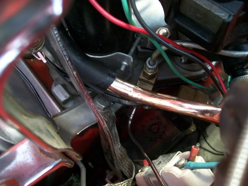

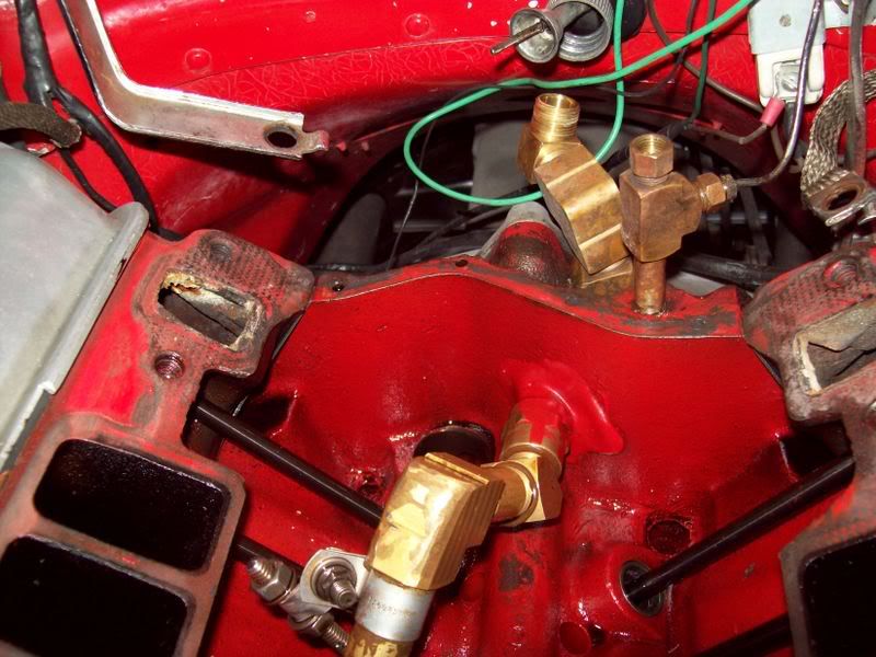

          I'm running a SB400 in the 56 with a home made PCV system and solid (NO HOLES) 9 fin valve covers. Oh ya, and the staggered bolt pattern 9 fin covers are on later straight across bolt pattern 2.02 heads (I had extra bosses welded, drilled and tapped in the heads).
          My point is that a 68-later SB's (no hole in the rear of the block for road draft tube or PCV provision) CAN BE modified and/or setup to provide adequate crankcase ventilation. I've seen some engines that have a hole with a grommet and PCV valve installed behind the intake runners for #7-8 cylinders that is virtually hidden. Works great.
          Here are a few pictures of the PCV method I devised for the SB400 in my 56. The PCV valve itself is a generic replacement for a 63 FI car, which has the same valve installed on the opposite side of the FI plenum.

                    Re: 330HP 350CI crate engine into a 1957
                    I did. Believe it or not, it works. The (3) holes to allow crankcase vapors to escape are in the cap at the very forward end of the plumbing. After various configurations, this is the one which works. By having the holes at the very front, almost up against the front wall of the lifter valley, this prevents oil splash from getting into the plumbing. Thus, for the most part, only vapors enter the plumbing. Doesn't matter what it looks like, it's covered up with the FI manifold and it (so far) is very functional! Laugh at it all you want, it works!!!!!!!!!!!!
                      I believe it! Actually admire your ingenuity.
                      Just one suggestion, to avoid any sudden heart failure issues. You should post a decal under your hood as a warning to any (possible) future owners of your car. The decal should read:
                      WARNING: Removal of intake manifold will release wild snakes. Use caution!
                      Here's how I made a lifter valley splash pan work with the old fashioned vapor separator.
