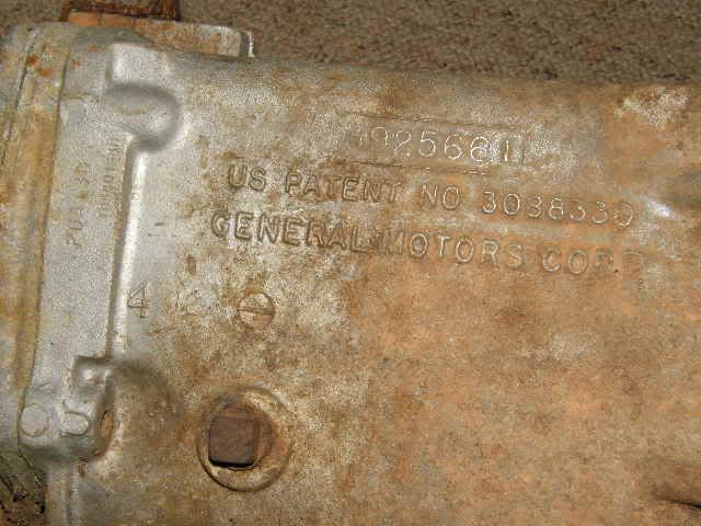

    i was looking at the trans on my 70 bb car trying to figure what is correct and what is not. the 4 speed trans in the 70 454 has a 660 case. i compared it to my 70 lt1 and it has a 661 case. i know the 661 is correct for the lt1 but not sure about the bb car. is the 660 correct or should it also have a 661? here is a pic of the lt1 661 case.

      Mike -- I'm no expert, but I follow these apparent inconsistencies on the many 4-speeds posted by eBay sellers. Seems that EARLY 1970 model year cases continued with the "660"; ie. those date coded P0Mxx and P0Pxx, (and maybe later as well).
      Does this jive with the VINs of each of your cars ?
      P.S. here's one on eBay now: Chevelle P0M14B (August 14th 1969 ?)
      Here's another off an early '70 Norwood Camaro: P0P08C (Sept 8th, 1969; M22)

        Re: correct 70 trans case 661 or 660?
        yes it does the 454 car is a february car and the lt1 is a june car.

          For what it's worth, my November built L-71 '69 has the 661 case. The "1" is very faint, like someone had made a change on the mold before it was cast. Just curious, is the correct VIN stamped on yours?

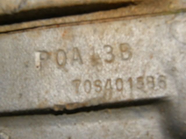

            This is the original trans in my June '70 BB.
            Tom
              my original LT-1 (70) has 660 case and is may/june car.
              Michael
