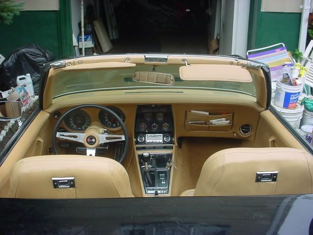

        Re: Interior Color
        Originally posted by John Gearhart (51026)
        The trim code for my 71 is 420 which I have determined is the code for a tan interior. I want the car to be correct and since I don't have any of the old interior pieces for reference, how can I determine what shade of tan the interior should be? Is there a color chart somewhere?
        When I redid my 70 saddle,(I had painted it silver), I was lucky enough at the time to get the original formula dupont interior paint mixed at a body shop supplier. At that time I was told that once the tints in stock ran out there's no more. The color was right on. The drivers door panel in my photo is painted, and also the w/s moldings/ steering column. The dash/console/ pass. side door panel are original.(new seat covers) You may get lucky and find a supplier, or try here......

          • Dennis D.
            • March 1, 2000
            • 1071
            Re: Interior Color
            My point was to show the paint match to the original vinyl using the dupont interior paint on my 70, not to suggest it IS the color for 71.(which for 70 is just plain old saddle... no dark/light)

            • Kenneth T.
              • March 23, 2008
              • 631
              Re: Interior Color
              Dennis,
              I understand. We all want to help our fellow members. I just did not want someone with a 71 without any interior parts to reference from to make a wrong choice. So many members here have helped me get it right and saved me a pantload of money buying and then redoing after I learned.
              I meant no slight to you and your post of really cool pictures, nice car too.
              Ken

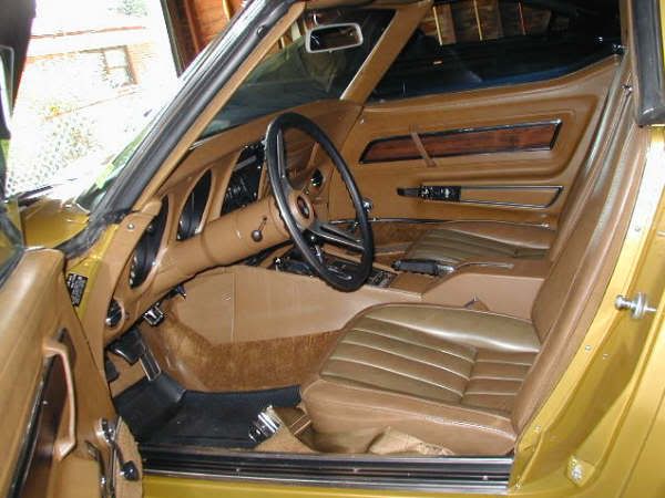

                  • Kevin G.
                    • February 1, 2005
                    • 1076
                    Re: Interior Color
                    How's this one?
                    • Kenneth T.
                      • March 23, 2008
                      • 631
                      Re: Interior Color
                      How's this one?
                      Perfect Kevin!

                          • Paul O.
                            • August 31, 1990
                            • 1716
                            Re: Interior Color
                            Here is my old 71 LT-1 Brands Hatch/Dark Saddle. Paul 18046
