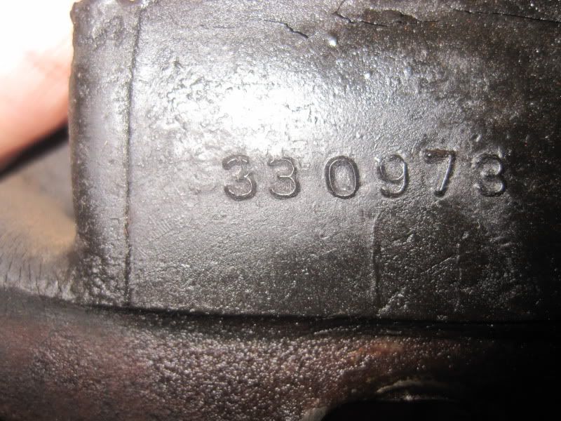

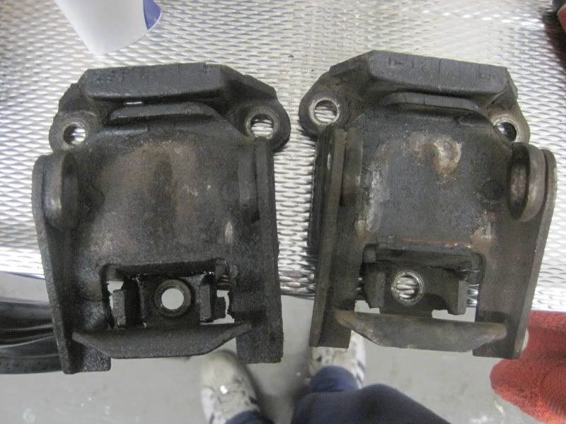

                      Now that we are on this subject: can somebody maybe identify these mounts that are from my 68 L71; I would think this is a later style mount right? Planning to re-use; good idea or not? Thanks, Erik

                          • 43247
                          Re: Can I reuse old Enginge Mounts?
                          Eric------
                          These are GM engine mounts first used in PRODUCTION for 1973 Corvettes and available in SERVICE for all 1963+ Corvettes thereafter. These mounts were sold under GM PART #6258154 which included the GM #330973 mount + attaching parts. The earlier locking style mounts, GM #3980701 and 3990916 were virtually identical.
