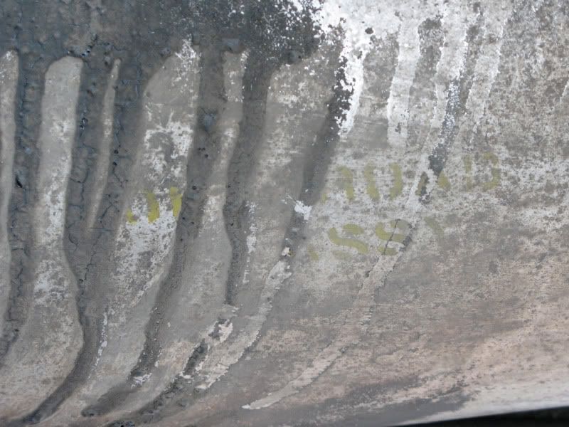

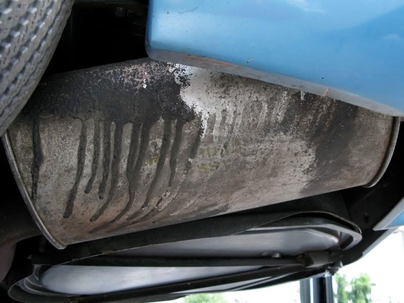

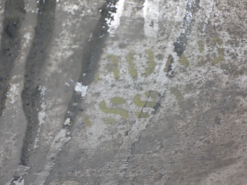

    The midyear N-11 mufflers were manufactured by Arvin, not Walker; Walker only made the standard production mufflers, which have the "W" embossment. The Arvin-manufactured N-11 mufflers don't have the "W" - just the yellow stencil.

          Dave are your n11 mufflers aluminized or galvanized thanks Ralph
          David are your n11 mufflers aluminized or galvanized thanks Ralph

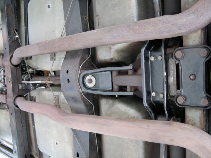

            Original muffler shells (standard and N-11) had an aluminized outer wrap; the end caps were stainless on the RH muffler, and aluminized on the LH muffler. Pipes were plain steel.
