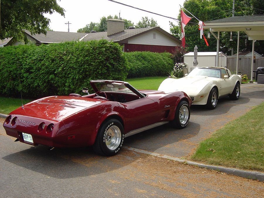

    (First let me say that I am glad to be back after an absence of about 18 months. I sold my 1967 coupe in August of 2008 after buying a 1974 convertible. I basically just lost interest in Corvettes in 2008 but things are perking up!)
    My 1974 roadster is pretty much stock with an L-48 and TH400. Lovely car with medium red metallic exterior and oxblood interior. A very nice, near-new black Haartz top.
    I am putting about in the basement this winter with a #340261 intake manifold that I picked up on EBay. It has been de-carboned and most parts (choke, spouts, etc.) are newly installed. My carb (on the car) is the correct #7044206 and the current EGR is #17051824 (I believe L-82). This is apparently incorrect and the proper unit is #7041409. The latter NOS unit I have found in New York State. It is on its way by US Mail.
    My question is very basic: what is the difference between these period EGRs and can they affect performance? I had an off-idle stumble last summer with the ...1824. I realize that there can be a host of reasons for that but could the EGR be one? My TCS has been removed and I am using intake vacuum for the distributor advance and TCS carb ported (t-stat housing thermal) for the EGR.
    The car is obviously not correct but still is a fun drive on a sunny Sunday afternoon.

                      Paul, thanks for the article, by the way nice pic.s of your corvettes, great looking cars.
                        Yes, I hesitated to come back to NCRS because my Corvettes are OK but not "correct" but we after all are enthusiasts in some way shape or form. My 1974 has a modern stereo with four speakers and a sub-woofer in back. The interior look is Willcox leather-like.

                          I'm glad to see you back. Your car looks great, as always. Not sure what you mean about the CF C3 section being 'strange'

                            Your '74 looks great, keep us posted on your progress.
