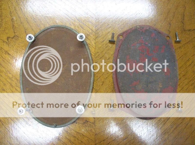

                Here's a picture of the top of the '59 screen and fasteners (on the right) and the bottom of the '60-'62 bezel and fasteners (on the left). The '59 attaches with t-bolts that sit under the pad. The bezel has studs that poke through the pad. The screen for the '60-'62 fits inside the bezel. I poked holes in my pad to mount the bezel. I don't think you'll be able to go back to the '59 screen if you install the bezel.
