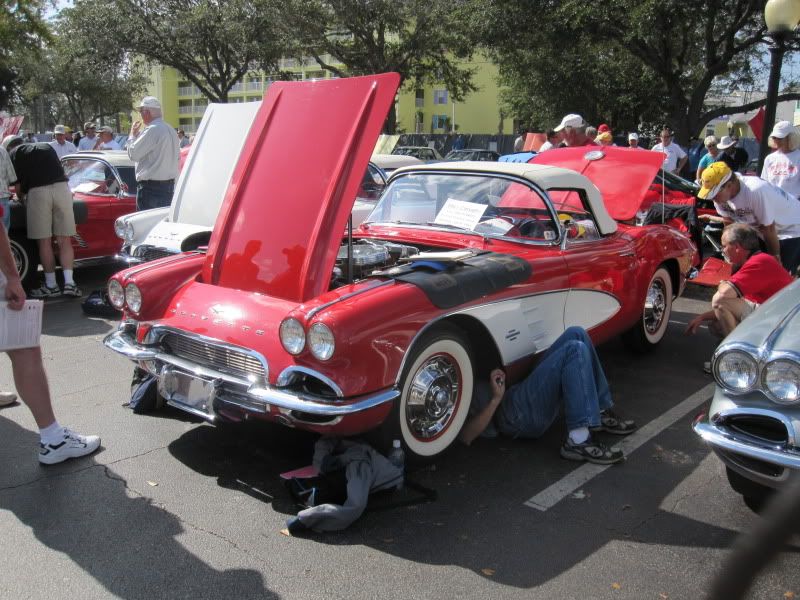

                That is how you get under them! Find a long armed skinny friend---or a chassis judge!
