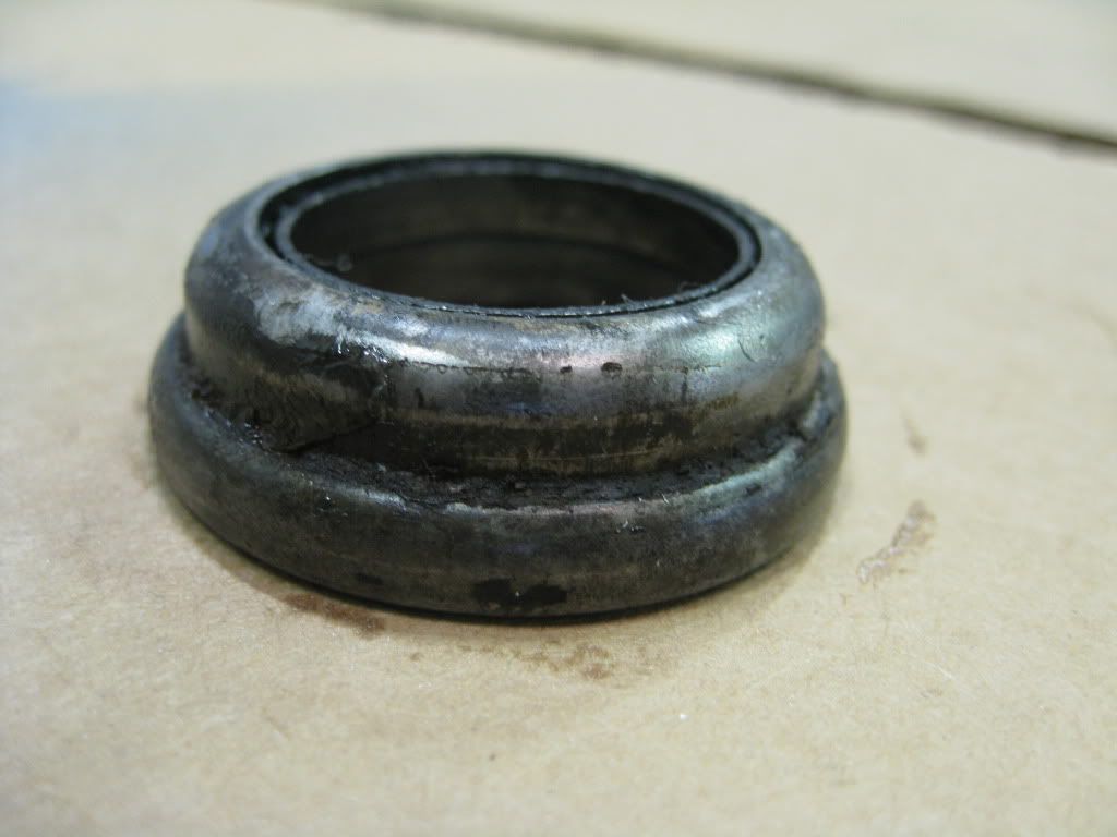

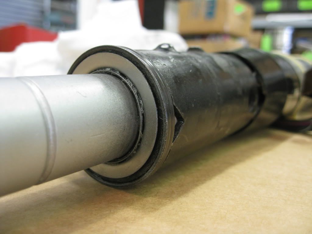

Don, I purchased from Paragon. From what I understand, this is a 69 column bearing that is OD ground to fit in the 67 column sleeve. I assume they can supply the upper bearing as well.
Here is the the modified bearing, installed in the column, and a photo of the OE bearing (which was trashed)
