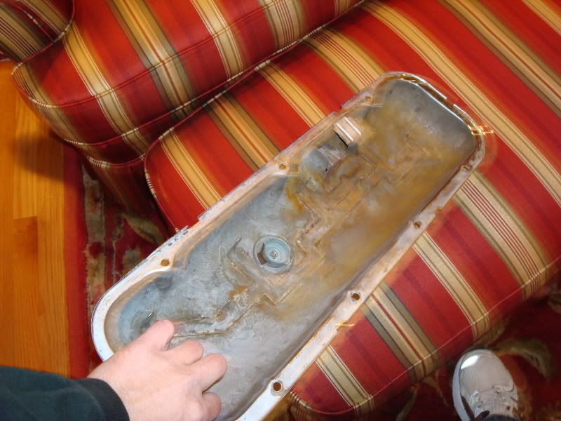

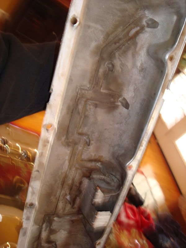

    Looks like they left the inside of all the pieces natural like underside of the valve covers and shielding is that correct?

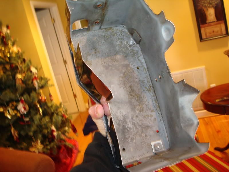

    one thing I wasn't happy with is on the under side of the shielding is a piece of plastic they took off and looks like they messed it up a little on one of the holes. They said they couldn't find replacements for the plastic spacers or something that went on the underside? what have you guys used for this after having that part re-chromed?
    I took them this piece but I have NO clue where it goes, anyone know?

    Brandon, although I am not certain about your unknown piece, I would say it is to serve as connectivety between the distributor cover and the air cleaner metal base. '64 SB has such a feature. Check your AIM.

        Originally posted by Brandon Thompson (49614)
        ...Looks like they left the inside of all the pieces natural like underside of the valve covers and shielding is that correct?...
        It's typical for plated parts to have insignificant plating on the interior surfaces for a couple of reasons: (1) the surfaces are hidden from view, and plating is not necessary, and (2) since electroplating requires the "throwing" of the plating ions from the electrode to the surface, the plating of interior surfaces would require a specially designed anode to reach up inside the closed surface. It would be more costly to plate the interior surfaces and it serves no purpose.
        ...one thing I wasn't happy with is on the under side of the shielding is a piece of plastic they took off and looks like they messed it up a little on one of the holes. They said they couldn't find replacements for the plastic spacers or something that went on the underside? what have you guys used for this after having that part re-chromed?...
        I'm thinking those were actually not spacers, but clear plastic rivets that are friction peened to attach the inner plastic part to the shielding. Those rivets may be available in reproduction, but I haven't scoped reproduction parts in a long time...Try Paragon.

              Branden,
              The plastic on the underside of the distributor cover is held in place with clear plastic rivets on my 71. When I had it chromed I cut them off with a razor blade. I cut them off on the back side. Then I kept the halves taped together. When the shield was returned I reinstalled the mylar insulation on the underside. Then I installed the top half of the rivet and superglued th matching half to the backside. Making sure that the pieces were allined properly.

                Yeah, I wish I had looked and noticed the rivets and the plastic like shield to take off MYSELF. Now I don't know what exactly the rivets look like etc to order them or exactly how they were on there. As you can see from the picture they messed the plastic sheet of sheilding up some getting it off looks like.
