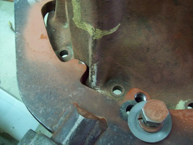

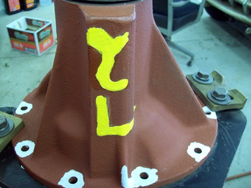

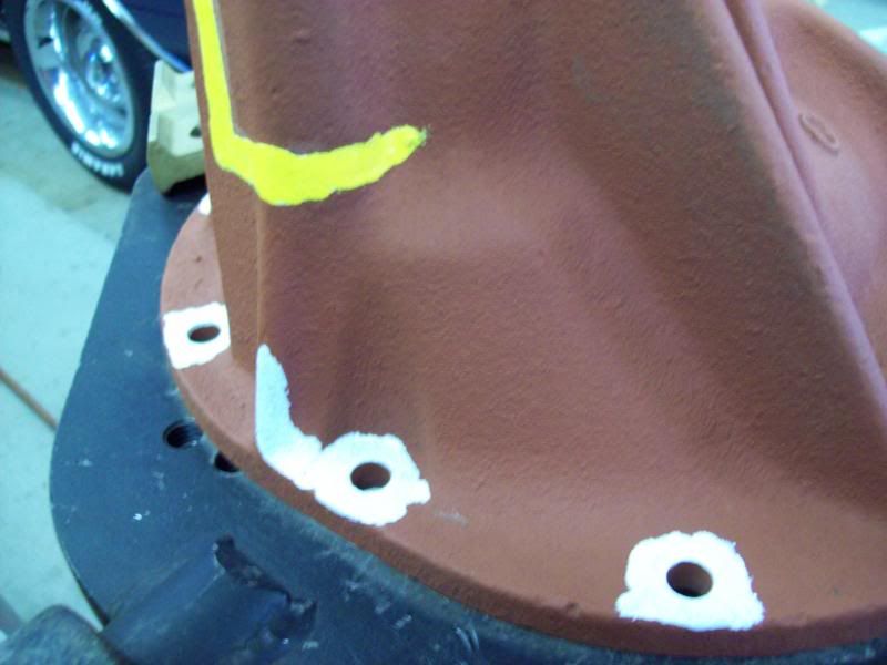

      I also would like to know about paint markings on rears, except the ones I rebuild are 62-earlier. I've been rebuilding the 56-62 (55-64 for pass cars) rears for 40+yrs and never paid much attention to paint markings, but it is now becoming more and more of a concern for people who are expecting exacting restorations. I've already inquired earlier with ZERO replies. So, since the issue has been brought up again, I'll give it a second effort.
      Below are some before/after pictures of a rear from a 57 Vette (3.36 non-posi) that appeared to have never been touched. The owner and I examined and discussed the colors and jointly concluded how it was to be finished.

          Tom, just curious - what was the assembly stamping on the non-posi housing in your photos? Gary....
          NCRS Texas Chapter
          https://www.ncrstexas.org/
          • Tom P.
            • April 1, 1980
            • 1828
            Re: C3 Diff Paint Markings
            The casting date is I286, assembly code/date is AE1004. This fits the car. It is an EARLY production 57 PG car with 3.36 gear, plus the R&P stamp dates are also early, 9-56.

                Tom, thanks for info. Unusual to see red oxide primer on a 56-7 Corvette rear end. Have tried since the 70's to find documentation for the different paint marks on 56-7's and my theory is; Yellow paint marks are identification paint marks to indicate Corvette, White was for passenger cars, Blue is to signify pinion nut was torqued. Others markings on gears, ring & pinion, etc. some are alignment marks and others? JMTCW, Gary....

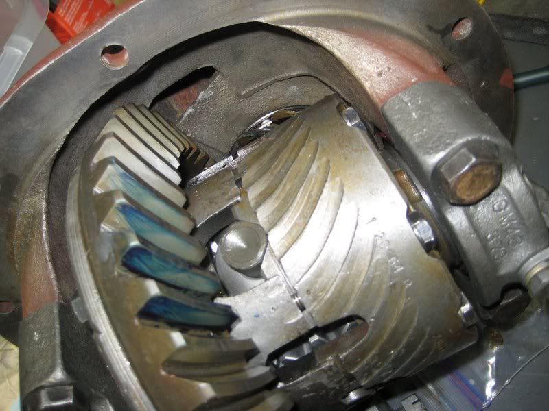

                  As best as I've been able to understand, all 55-56 and early 57 cases were painted with red oxide----------inside and out.
                  Just by observation, when I clean up the cases, it APPEARS that the case is painted red oxide BEFORE machining is done. Correct, BEFORE the machining processes. On this rearend case, I especially examined it closely. It is painted EVERYWHERE, EXCEPT where machining has been done. Thus, that means it was done BEFORE the case was coded or designated as either pass car or Vette use. I get VERY FEW 55-56 rears, and in the past, I've not paid extremely close attention to how they were painted, but as best as I recall, all 55-56 rearend cases that I've touched were painted red oxide. The 55-56 Chevy guys who do exacting restorations, are insistant that the 55-56 case is painted.
                  Below is a 56 rear, that had a posi added BEFORE I touched it, and as you can see, it has remnants of red oxide.
                  By the way, the bearing caps of these rears have not been painted.
