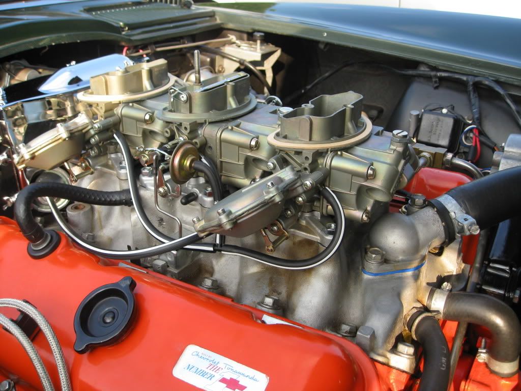

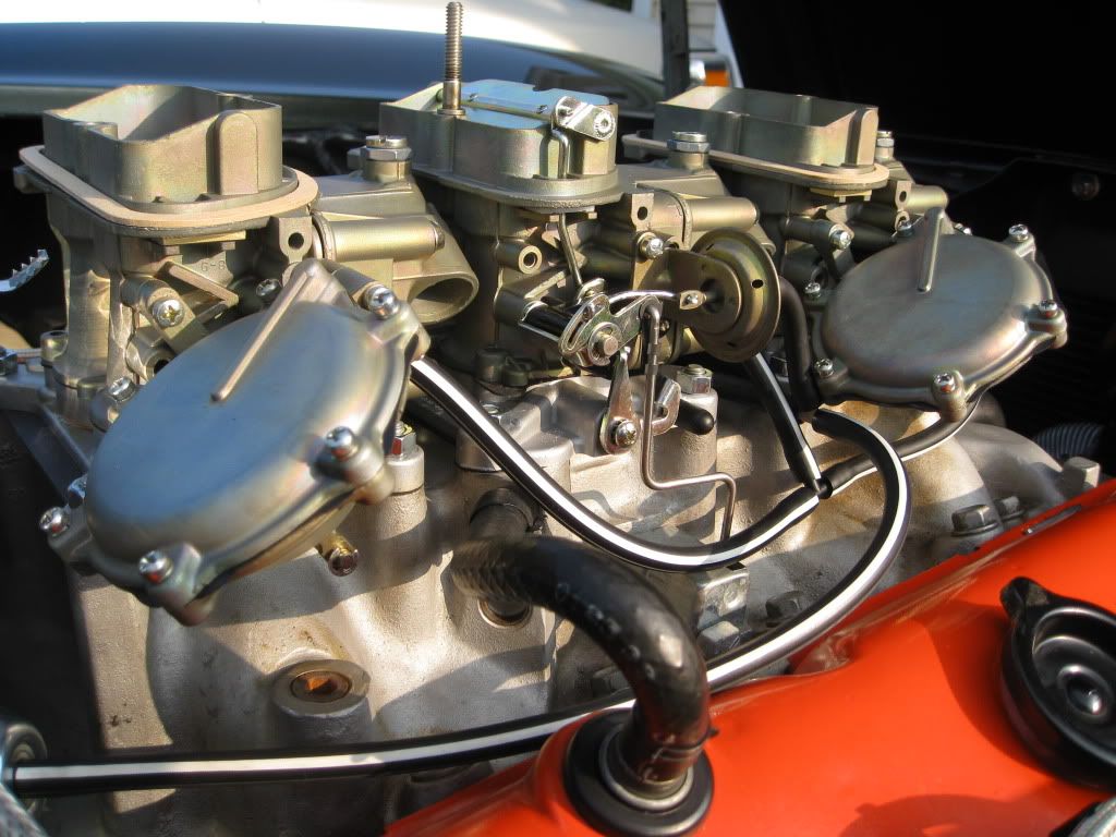

            Re: Converting ported to full time vacuum advance
            Here is the conversion on my 427/400:
            I am also using the B26 cannister which is listed as a replacement for B20 (B20 no longer available through NAPA). I have verified its specifications against the B20 and found it it to be the same. Installed in the car, I have observed the B26 can actually produces 18 degrees of crank advance (probably within tolerance, but more than I wanted). I limited it to 16 degrees with a simple sleeve on the rod.
