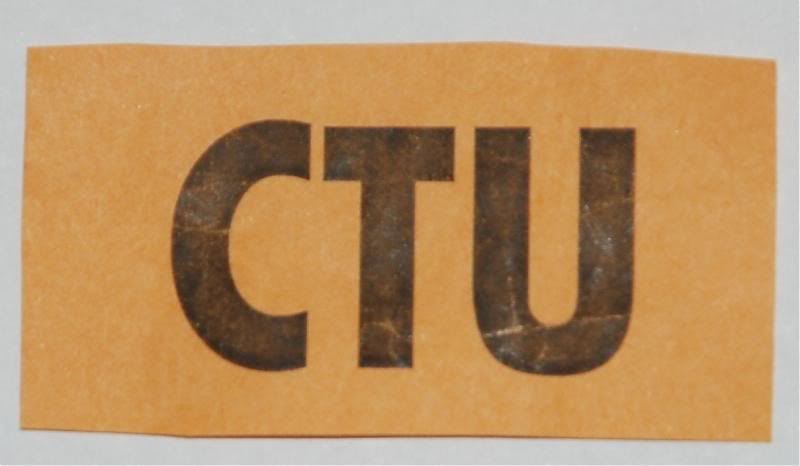

                      Here's a 1970 CTU I obtained from the Forum.
