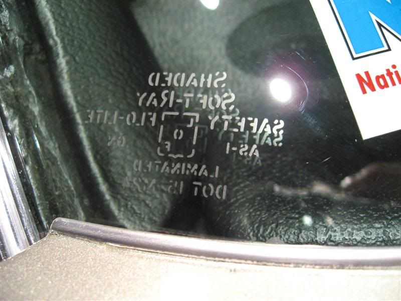

    Here's a pic of the replacement windsheild on my 71.....it was giged 2 pts at a regional.

      Thanks Gerald,
      What did you get the deduct for?

          Thanks Dave and Gerald...that what i needed. is it supposed to be backwards? or is something transposing?

            Those photos were taken from the outside, passenger side, lower corner. I guess backwards would be the correct description.

              The 2 pt deduct was for a replacement windsheild and I assume it was because of the DOT info.

              Dave, if your camara has a Macro setting use it. I took my pic off to the side a little, not head on w/no flash.

                      On my 71, #6589, the logo is etched on the outside of the glass but read from the inside. I believe this is typical.

                          My 71 is marked like the above photos too.
