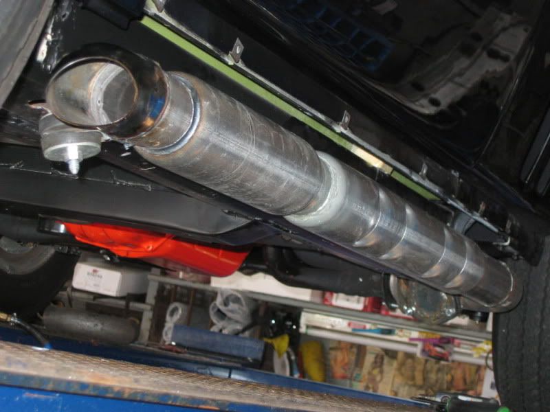

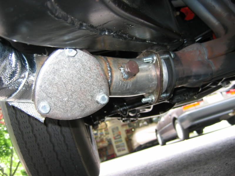

            Here's an installation using Hedman sidepipe headers (to be ceramic coated winter 2010-11) into 3 1/2" x 2 1/2" Vettepacks using triple chromed steel tips.

              Hi Joe
              I like the "Cut-outs", nice touch.
              And you thought the side pipes were too loud???

                Re: Alternative side exhaust mufflers
                Originally posted by Mike Murray (25129)
                Hi Joe
                What are your 1/4 Mile times?
                HaND
                Thanks for the compliment Mike.
                I had the car to Raceway Park for the first time last week. It was HOT, with heat index over 100. Carb is set on the "lean" side, for now, and with the cut-outs closed, poor launch on the "bicycle tires" and careful, slow shifts, the trap speed was 107 MPH. Shift points were @ 7000 RPM.
