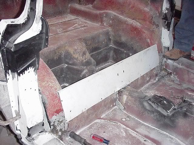

    Does anyone have any photo's of the C2 birdcage B pillar in the area of the gutter/water deflector? I am uncertain of the ccorrect configuration and would appreciate any help. Thanks.

    Thats pretty bad. Although not as bad, I had a similar problem on my 65. I took a lot of photos of the repair process. When I get home this evening I will look to see if I have what you need and post. I was able to complete a repair on the area by cutting out the rust and replacing with the appropriate guage sheet metal. You may be better off finding donor birdcage parts in your case.

        Thanks guys. It's the configuration of the actual birdcage that I am interested in. I removed the damaged portion of the B pillar for ease of repair. I'd appreciate any photo's of this specific area. Thanks again.

            some pics.

              Guys, that's it! Between the web page and the pictures I should be able to put the B pillar back the way it was intended. Thanks!

                The upper B pillar was successfully rebuilt and has been reinstalled. Thanks for the pictures.
