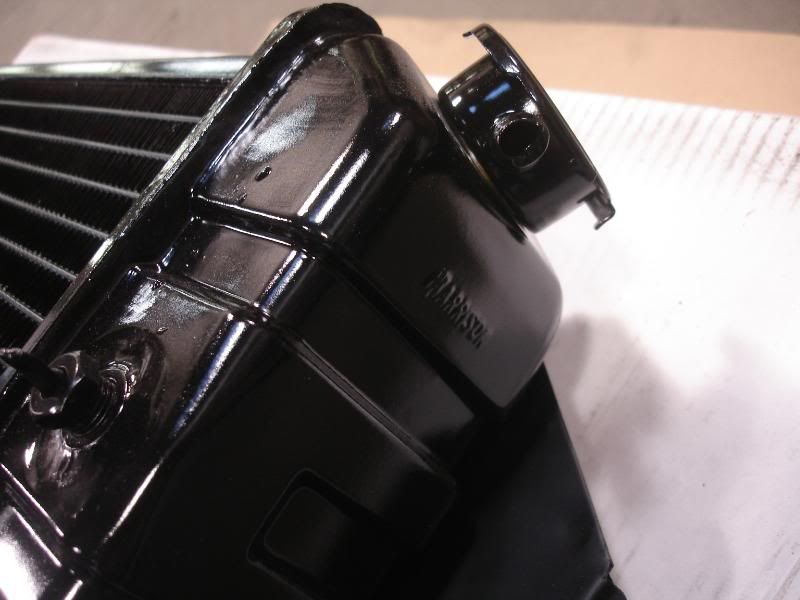

            If, by your asking if a copper core is acceptable, you are implying that you think your original is aluminum, it's not. All 1973 Corvettes were equipped with a copper/brass radiator. If you have any doubts about the condition of your original radiator, you could have it checked out by a competent radiator shop and/or have it re-cored with an original style core. Then, you'd have an as-new radiator with the original Harrison tanks.
            Good advice. I actually bought a DeWitts aluminum radiator with the intention of putting it in my Top Flight '73 big block. However, once I compared it to my original, I just couldn't bring myself to do it. So my original is getting cleaned up and re-cored:
              William-----
              The DeWitt's "Direct Fit" aluminum replacement radiators are just that----a replacement radiator. However, their configuration is very close to the original copper/brass. The most prominent differences are the weld between the tanks and the core and the lack of the Harrison embossment. While there are these differences which can be a negative for a judged car, there is a big positive from the standpoint of cooling performance.
              This, particular "Direct Fit" model has a significantly higher cooling capacity than ANY original Corvette radiator ever used from 1953 right up to the present. In fact, it has a cooling capacity which is about 30% greater than the 69-72 big block copper brass, 67-69 L-88 aluminum, 70-72 ZR-1/ZR-2 aluminum, and 73-76 copper/brass. All of those original radiators had about the same cooling capacity and that capacity was the highest of any radiators originally installed in ANY Corvette. So, if one wants to have near-original configuration but MAXIMUM cooling capacity, the DeWitts "Direct Fit" is the way to go.
              By the way, I do know of Top Flight cars that have the DeWitts "Direct Fit" installed.
