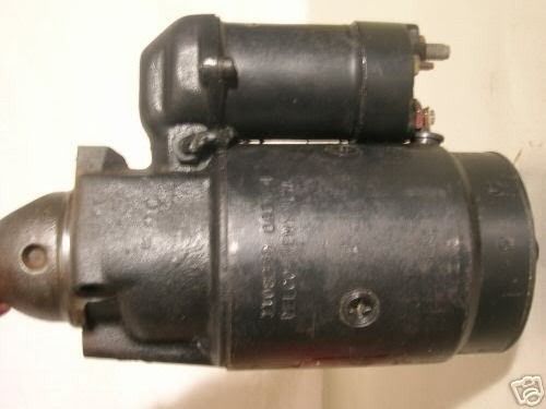

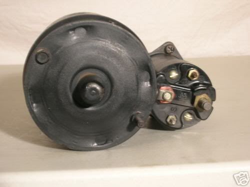

            I bought this from a guy a couple of years ago. He had bought out a parts garage and had a whole bunch of these nos. Think all are early 70 date. Even the solenoid is of the original style. I'll see if I have a contact for him

                The starter that you will need for a 168 teeth flywheel/621 style bell housing MUST have a cast iron nose with a staggered bolt pattern (specifically referring to a STOCK style GM Delco starter).
                If you have a starter with an alum nose and staggered bolt pattern----------IT WILL NOT FIT INTO THE BULGE of a 621 style bell housing!
