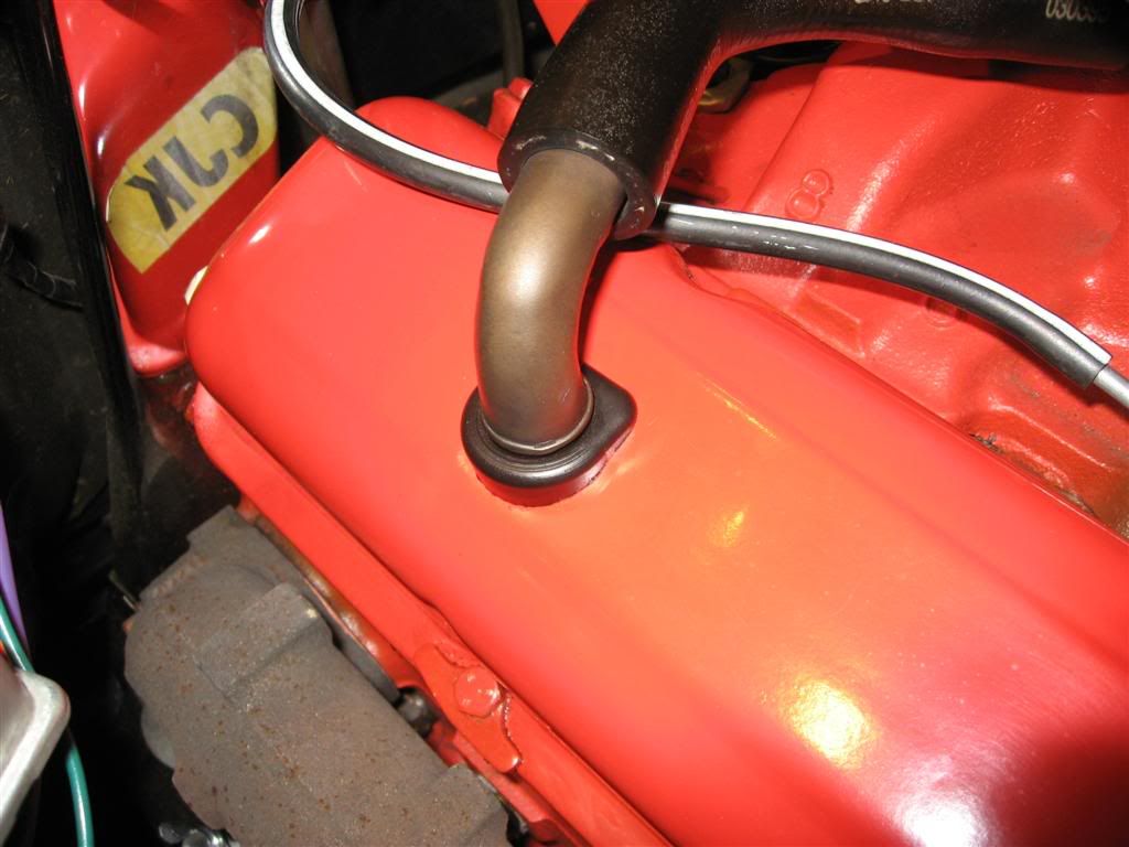

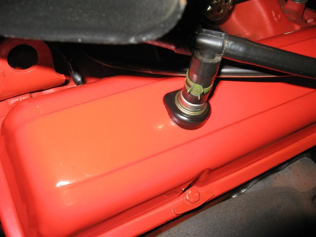

        Re: 71 valve cover grommets
        Both are the same on my 71 sb
          • 43221
          Gerard----
          Yes, GM #3989350, the grommets you have pictured, were used for both sides. Was every, single 1971 with base 350 done this way? I don't know. There could have been exceptions.
          By the way, what paint did you use on your engine? Was it the Bill Hirsch-supplied Chevy Orange?
              Gerard----
              No, we used VHT Chevy Orange.
