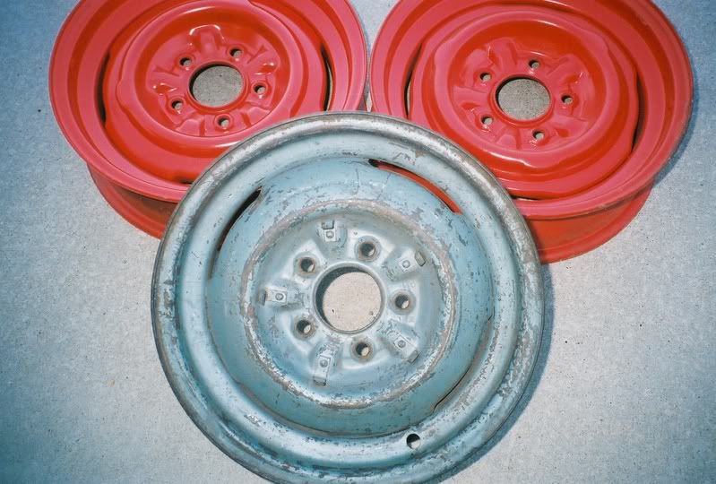

          By no means do I come close to claiming to be a 53-62 wheel expert.
          But below, is what I generally understand to be the differences.
          The picture shows 53-62 type wheels.
          The blue wheel is from a 51-52 pass car, which is essentially identical to 53 wheels (both pass car and Vette). The ONLY difference is that those reiveted-on clips (for retention of dog dish caps) are NOT on 53 wheels.
          As I understand, 54 and 55 wheels were the same. SOME say 54 wheels are different and DO NOt have the nubs to retain the full size wheel covers, but according to Noland Adams, they do. Soooooooo?
          The 54-5 wheels were riveted and the 56-later wheels were welded. The center hub of 55 wheels, JUST OUTBOARD of where the nubs are for retention of the dog dish caps is smooth, whereas the 56-later wheels have an additional ring or line or groove or whatever you choose to call it, as seen below.
          Reiveted vs welded
          Nubs for retention of full wheel covers (on both pass cars and Vettes).
          And still the big question seems to be, did 55 wheels have these nubs? Well, for sure, the Pass cars DID have them. So why would Chevy make a completely different 5x15 wheel without nubs just for the Vettes??? I think not!
          And then in addition to that question, were the 54 wheels the same as the 55 wheels with nubs. Again, as I said above, Noland's book shows nubs on 54 wheels.

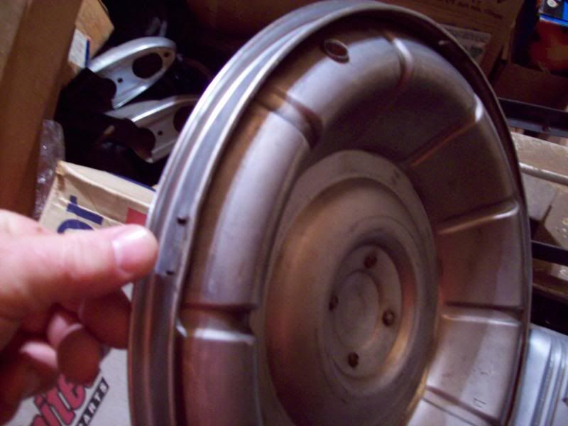

                  The 56-62 Corvette full wheel covers are all the same, except for the slots in 59-62 covers. The Vette as well as pass car full wheel covers have locating slots on the back side where they fit over the nubs on the wheels (in 1957, pass cars went to 14in wheels, but STILL had the nubs!).
                  This is one of the full wheel covers off of my 56, and on the back side, my thumb is showing one of the slots that fits over a nub on the wheel.
                  Tell your friends there is nothing wrong with being incorrect. What IS wrong, is being too stupid to learn something new. Print this out and show it to them!

                      The way to know your looking at a original hub-cap is to look for this

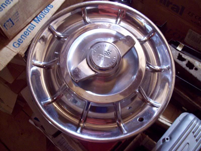

                        A couple pictures of "53"-"55" Caps.

                          Re: "53-55" Wheel Rims.... What is right?
                          53 thru 62 full size hubcaps installed on nub-less rims will end up in the ditch alongside a bumpy road. speaking from experience. mike
