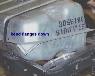

    I just removed the gas tank from my late '64 and noticed a barely-visable stencil (in black) on one end of the tank...... I can make out the word "Louis" and most ofthe part number "3819506" under it. Can I assume the word "St." preceeded "Louis", or was something else used? A glob of black paint covers whatever preceeded "Louis".
    Also, when the tank is in the correct up-right position, the stenciled information is "up-side down"..... is this correct?

    Yep it's St Louis. Go to Quantas web site for more info. Not all tanks are marked.

      borrowed photo that was posted before

        Thanks for the pictures...... very helpful....
        Another question..... what was the original finish on the tanks? My tank is original and has never been out of the car. When I pulled it the other day, I noticed that the finish of the metal under the straps had a "galvanized" appearance. Is this just an aging effect of the metal, or did the entire tank look like this when new?
