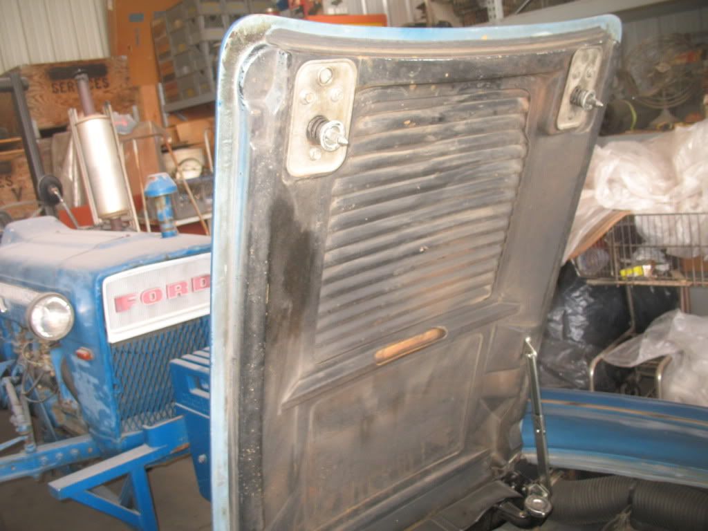

        Originally posted by Brandon Thompson (49614)
        I agree I don't see that circle as a wear mark that's made like that which is what I'm asking is that a clue as to is it original or not.
        you seem to think it's not sounds like.
        thanks!
        No original or repro that I know of has that circle. It would be a little stupid to make a reproduction hood and do something like that wouldn't ya think? If its not a wear mark, then someone intentionally cut the relief for some reason. The hood itself looks original as far as I can tell from a picture of that quality, but the mark certainly isn't.

          Brandon,
          It looks like in the center (or slightly off center) of the circle there is a mark possibly made by the air cleaner stud.
          Can you give your opinion on what it is ?

              It looks like someone modified the hood to make additional clearance for an air cleaner.
              A previous owner installed a 350 in my 1960 with a low profile manifold and Edelbrock carb and I searched real hard for an air cleaner that would clear everything and still give adequate filtration. I couldn't find a good alternative and Edelbrock and Holley could not suggest a manifold that would give me more clearance.
              If it is an original hood then the ribs could be repaired without too much of an issue.

                  here is mine as you can see it's a completely different hood so I can't modify it to make it look original.

                    I don't think that is a GM piece, further I cannot understand why the circular indents on the inside do not show on the outside. I owned a late '58 with an original hood and there are seem to be a few other 'anomolies' that makes me question it's originality, like where are the hood hinge mounting plates?

                          i know its a little late to comment on this hood, but i was looking for something else and noticed brandons hood has a 1960 frame under it, so no, not an original piece

                            Let me make it simple, the grooves in the louvers don't belong there and were not on original hoods. better to look elsewhere...

                                This is an unrestored hood from vin 4201. The cut out was made in 1965 when the son of the original owner added 3x2 Strombergs which were on the 327 engine when we found the car in the barn in 2003 here in So. Cal. Hope this helps
