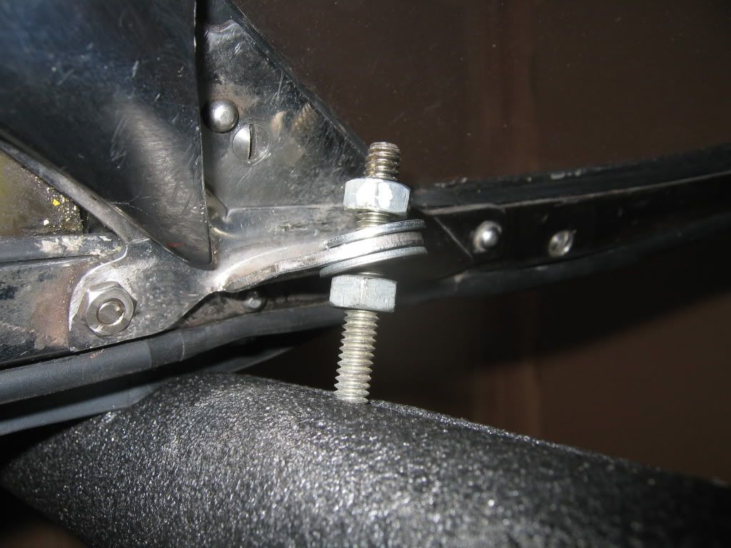

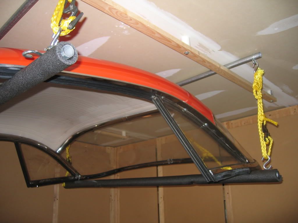

        Below are pictures of how I store my hardtop which hangs from the ceiling. Taking it off or putting it back on is made easier by utilizing my car lift although it can still be accomplished by one person (with longer ropes). I put the two insulated bars under the top and then raise it with ropes. The bars I use under the top are 3/4" x 5' electrical conduit (from Lowes $3ea). To avoid damaging the weatherstripping, I drilled holes in the rear conduit crossbar and installed 1/4" X 3" carriage bolts which go through the hardtop side fastener brackets. The bolts have threads all the way to the bottom end so I could secure the bolt to the conduit. I then added a nut below and to the top of the "hardtop" side fasteners (the lower nut supports the weight of the top thereby protecting the weatherstrip). The top rests on the front bar which is not attached to the bar. I covered the conduit with pipe insulation (also came from Lowes for approx $2) and it works well for keeping the deck lid from being scratched when maneuvering the top. I hang the top from two additional conduit pipes which are supported from the ceiling in such a manner that I can move them side to side or front to back to align with the car. I have to push them back a couple of feet to keep the top clear of the car when the softtop is up. The support tracks for the upper bars are made of 1x2 furring strips and are attached to the ceiling (screwed into the ceiling joists with lag bolts). I've sandwiched 1 1/2" spacers (I used 1" pvc pipe as spacers) between the furring strips and ceiling to allow the bars to be moved about.

          Wow, I'm impressed! That is a great setup. Thanks for all the great input as always.

            Wow! What a great set up. Right now I have a peice of wood across the bottom of the front on my hard top. Your design is much better.

                        Valerie - I was not concerned about the weatherstripping drooping as much as it becoming compressed by the hoist hooks. That is why I designed my rear bar so that the top rests on the top's side fastener's instead of the weatherstripping. Also, since the top is supported by the fasteners, I am hoping it is supported in the same manner as it would be on the car and thus keep it from warping.
