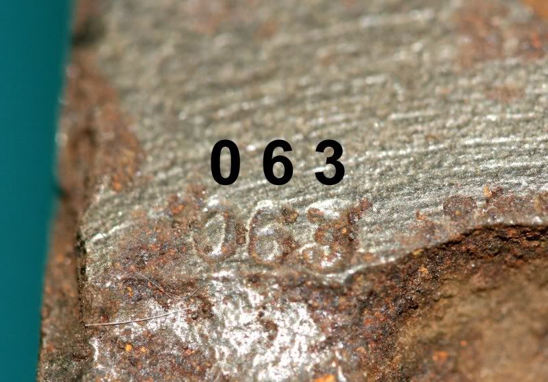

      Second, it is the belief of a few of us that the calipers were date coded when assembled. I've seen NOS caliper halves without the codes, but complete calipers with them, thus my conclusion.
      Below is a photo of the machined area on the top of one of my calipers. It shows a 3 digit code that I think is 136. Unfortunately the picture was taken after I painted it. However, I've seen calipers from a 1970 that are stamped "063". Interestingly it "appears" to be the same font and size used to stamp the date codes on a master cylinder.
      I do not think that date codes were cast into the calipers, as by now we would have figured that one out.
      If your casting numbers are correct then you "may" have the original castings. If you find any stamped numbers like below, please let us know.

          I checked the front calipers - they all have the correct casting numbers. I haven't checked the rears yet. Where would I look for that three digit code stamp?
              Steve
              Steve,
              Look at my picture above.
              Top machined surface.
              Patrick

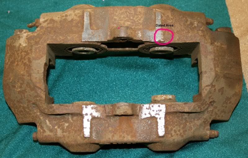

                      Re: Better to restore calipers or buy new?
                      Please excuse the cat hairs in the PICS. This caliper is from a 1970 Corvette.
                      Kramden
