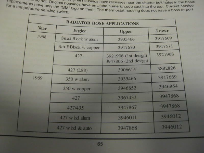

        Also for your reference, below is a picture of the chart on page 65.
        -Dave

          Re: 69 L46 Radiator Hoses
          OK, that's perfect !! Thanks again Dave, appreciate the info and quick responses !
