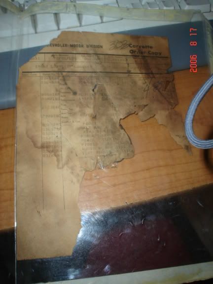

    Just beginning a complete body off on a recent purchase of a 70 convertible that's almost too far gone. It qualifies for a barn find as it was sadly found outside and behind the barn. Last night I anxiously removed the gas tank for the first time ever and found the build sheet as hoped. It had folded over onto itself (only being glued in the center portion) and isn't in bad shape after all these years. My question relates to the job number or hand written number on the sheet - mine has two and they're different. There is one written in the usual place on the right side just below the heavy black line (439) with the other written near the top (311) just left of the words "Corvette Order Copy". I have found the 311 written in crayon on the back side of the convertible top storage compartment. Both numbers on the sheet appear to have been written by the same person - at least the 3's look the same. Anyone else have similar knowledge or know what the other number (439) might be?

    I would guess your VIN# ends at about 44x or 94x......
    This number your are talking about was close to the last 3 digits of the VIN#. If the VIN last 3 digits are over 500 then the number starts over. It appears these numbers were assigned in batches of 500.

      Re: 1970 Tank sticker job number(s)
      You are spot on - my VIN ends in 439 which is what's on the tank sticker. I didn't pick up on it so thank you. I also have a 71 and a 67 both with tank stickers and neither have their VIN's marked on the build sheet.
