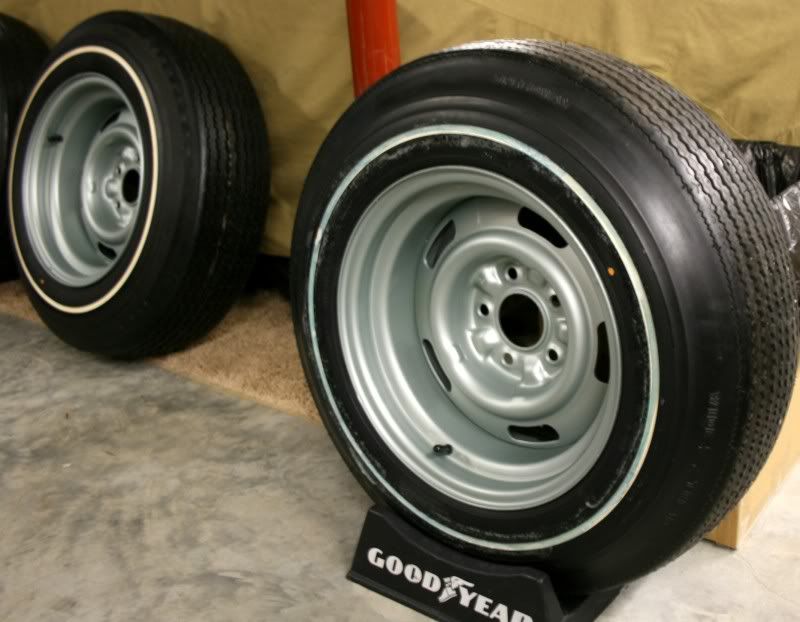

    This has been discussed many times already I know. Just struggling to get it right on my end.
    I have an original wheel I'm trying to have matched by a local shop but they are missing. They are trying to match the poor coverage on my one original wheel. Since it is black underneath they keep coming back with dark silver, no green tint - although they say it's in there.
    Does anyone have a formula I can give them to get it right?
    Should there be metal flake in the mix? I don't really see it in the original but they do. The original has such poor coverage and inconsistent color it is not easy.

    This subject comes up rather frequently... The wheels were painted 'Argent Silver' and it's known the formulation used from '67-70 had a greenish undertone. From '71 up, it's generally accepted that, while still called Argent Silver, the formulation changed and they lack the greenish undertone.
    Now, getting a 'correct' shade of Argent Silver for the early cars is more of an artform than a formula... Different judges have different views as to what is 'correct' and that complicates things.
    Search the archives for threads on the topic of Argent Silver and you'll find a LOT of prior discussion(s). But, be forewarned, I don't think you're going to find a UNIVERSAL agreement as to what blend method is actually 'correct'...

          Well I have my match and the wheels are painted. I will have one original paint wheel on the car so it will be a good comparison for judging. If I get good results from the judges I'll have a source for an acceptable color.

              I would've been thrilled to pay $60/can from Paragon but they don't have it in their on line catalog. Maybe I should have called them. I had to make about 5 trips to the paint supplier to get the mix right. It's a pretty good match now.

                          Out of my five original AZ wheels, one had very nice original paint remaining. My restorer shot a color match that came out dead on. There is quite a bit of green in this paint. I judge 68-72 mechanical at most of the regional and national meets and I've never heard Ballard busting anyone's chops too badly on too much or too little 'greenish hue.' I purchased a can of the greenish rallye wheel paint a while back from OEM and it wasn't even close although it was expensive.

                            Well I will report from my own experience that there was not much of a green tint to my original wheel. Some, but not as much as I have seen in some pictures including this one. I imagine there may have been some variations from time to time. All my wheels are dated the same, and all but the spare were painted once with the standard argent. I went back and forth with the paint supply until I got a close match. It has some blue & yellow to provide some green tint but not enough to take over from the silver. I do have a sample card that will be available for the judges to compare the one wheel (which will be mounted with three re-paints).
                            One thing that made this process difficult is the poor coverage of the original. As it is sprayed over black, and was obviously a speedy operation, there is a fair amount of black showing through plus some areas with runs.
