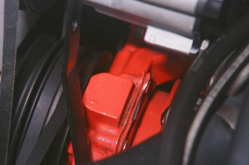

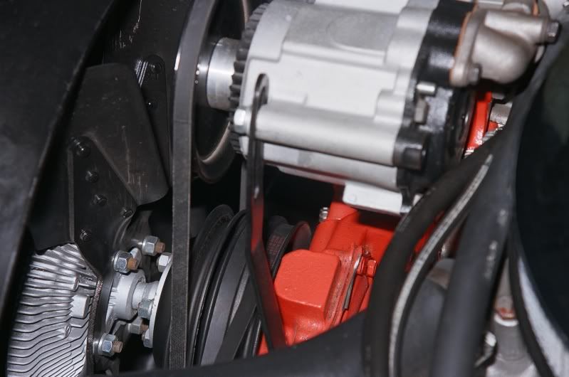

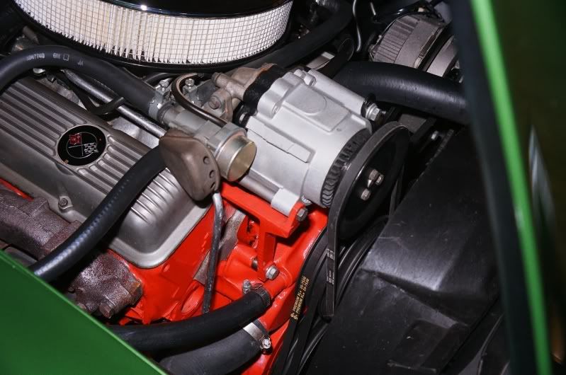

          Patrick, sorry for the delay in getting back to you concerning the waterpump.From what I have determined, I have the 330813 water pump because of the large untapped boss
          I tried and tried to find the casting date for the pump, because all of the hose connections and fan shroud and A.I.R. pump and its related hoses, I couln't find it and I don't have access to a lift at the moment, I will keep trying(perhaps with a very bright flashlight and a pair of binocs)

            V0628CKY
            Nice car.
            With an engine assembly date that late I'm not surprised you have the 330813. It appears that the 3991399 changed to the 330813 on production engines sometime in May.
