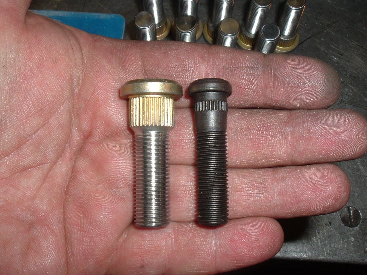

              You can find the studs most places. The studs have a kurl on the shoulder that cuts into the flange and holds it in place. They can be drive out but you'll find the parking brake in the way, removing them is more of a hassle then installing the stud! With the shoe on one side removed, I would block the back of the flange so any impact isn't going to shock the bearings. Then you can drive out the broken stud. Get (1) 7/16-20 nut,a spacer, and a flat washer. Place the stud through the flange and align it with the hole as square as you can. Place the spacer,could be a 1/2 nut just something to clear the stud threads, grease the washer and place it on the spacer,screw the nut on and draw it into the flange until seated. Install the parking brake shoe. Enjoy the car.
              FYI, as long as you're not hammering the car hard you can drive with 4 studs without much fear of the wheel falling off.
              Here is an 82 arm I did for a fellow corvetter so you can see what you have to work with once you get the rotor off.
              Here is top view from another arm I did
              When I build HP 31 spline axles I usually step up to 1/2-20 ARP studs. Some guys want stock length studs so I machine them to size. Here is a stock stud and machined ARP. You probably don't need the ARP stud but here is what a good stud should look like.
                    Great pictures I figured I would have to remove all of the e-brake stuff but that makes since just to pull one shoe. That's my project for tomorrow.
